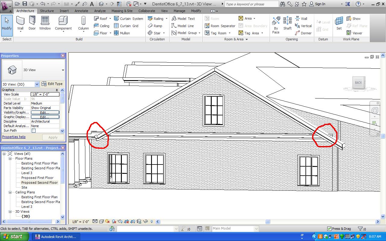

Anyone think they know how to get a wall sweep I created to attach to the roof above? The wall itself attaches just fine but the sweep will not, and comes through the roof above. Any help is greatly appreciated. Picture is attached.
Thanks!

If that wall sweep is not part of the wall definition, you can pick on it and drag the end back using the button on the end.  HOWEVER, that is all you can do.  It will always be a square end and will not join to anything.

Thanks for the help. That works good enough for now.
