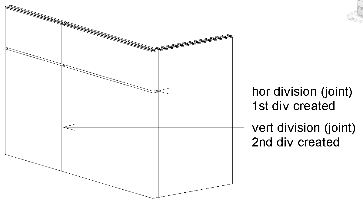

Hi thereI have created concrete wall panels as Revit walls and created Parts from the walls. I have then created multiple divisions, 1 for a horizontal (stepped) joint and 1 for Vertical (notch) joints. Now I have multiple parts but I am unable to access a particular division to edit it (eg the horizontal joint which was the 1st division created). I seem only able to edit the last one that was created (eg the vertical joint which was the 2nd division created) by selecting one of the new parts and hitting edit division tool. (see attached).I can't seem to find a way to get into the nested division conditions other than deleting the last one created (effectively deleting a part), therefore giving me access to the previously created division. Any help would be appreciated as I don't want to go down the road deleting divisions of scheduled parts (that have assemblies created from them) just so I can access another joints profile settings.Thx, Blair
