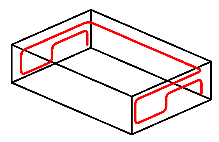

Hello,
Anyone knows how to do in Revit the rebar shape like in image I send atached?
Best regards

This can be done as a detail item, just draw the lines like you want them, or an extrusion, again just draw it as you want it.

The REVIT Multi-Planar tool for rebar is cool but will not give you what you want.
It just makes a copy of the base profile and attaches the two profiles with a rebar segment.
Detail elements are only 2d.

Right Daryl,
I had never worked with the rebar families - the multi-planer doesn't work.  Why didn't they use their standard modeling tools?
I would be tempted to model in a generic family and import into a rebar family.

Thanks for the help.
Is what I think, just in a 2D detail we can do this, what is not enough.
