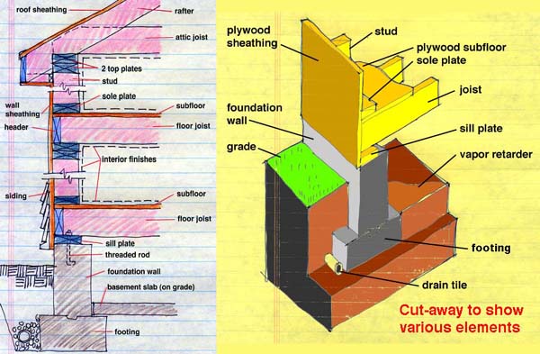

Although, I am not sure this will do what I need, this is more of an exploded view (at least the example). I need the building to stay as one and make cuts through different spots for each materail.  I will try to find an example.

kind of like this, the way the grade is cut further back but I need to do it with each change in material.
