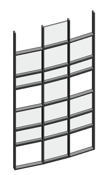

Hi,
I'm editting a curtain wall panel which I didn't create. Some how some of the panels have been deleted and replaced with nothing.
See the attached image which shows the wall sectioned, you'll see that the top row has glazing in the middle and the panels to the left and right are missing.
I need to replace these empty panels with glass - but I can't because there is nothign to select and so I cant change the type.
I tried changing Curtain Panel in the type from None to System Panel: Glazed - but that didn't change the emply panels.
Where am I going wrong?
Cheers.

OK, I'm being a complete idiot.
The reason the panels were blank was because when you pick the wall to isolate it, Revit doesn't select any panels which have been changed to windows, and so they are not isolated.
I'll go for a cup of coffee, that will help.

Revit also has a default "empty system panel".

so if I have a large wall with system pannel empty as the default and wanted to change some to solid panels, how could I select the empty ones?

You can still select an empty panel – use tab key, or window select panels and mullions and use filter tool to get panels only.

Forgot about the filter. I couldn't get it to work tabbing. my mullions are 1'x1' so finding where the pannel would be was confusing. Thanks
