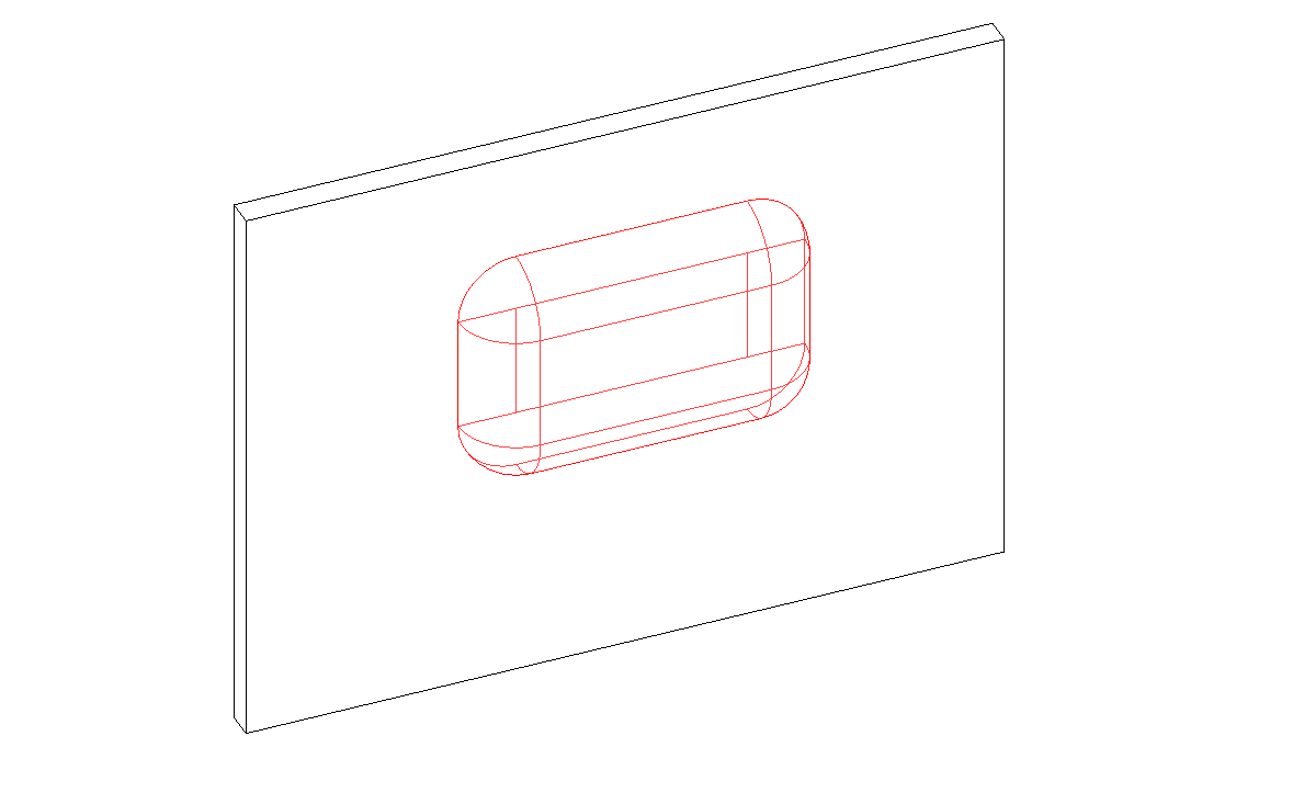

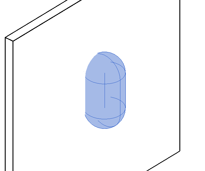

Hello, I'm trying to create a wall hosted lighting fixture but I'm having issues with the light source direction. I'm trying to set the light to come from the wall (left/right direction), but it's by default paralel to the reference level; as seen on images 1 and 2. Now, if I rotate the light source to fit my needs it won't appear in renderings. I'm wondering if there's any way I can do this. I'm not sure if I'm doing something wrong or maybe trying to achieve something that's just not possible.
Thank you.

You mean like this?
Go to anjother view and rotate there.

Like this, actually, but when I rotate it to this position it wont appear in renderings anymore.

Your light source is a line.  That line must be in front of the wall - not in it!  Move it out to where your light bulb would be.

It's actually a rectangle. I've tried creating an unhosted lighting fixture family and rener it, it renders correctly, the moment I try to rotate it it stop appearing in the renderings. I don't know if I'm soing something really wrong or just rationalizing it the wrong way.
Wed, Jun 5, 2013 at 2:48:23 PM | Issues with Light Source in Revit 2013
I have never used that light source.  When did they add that?
I checked it out and that family seems to have a bug.  Report it to AutoDESK.
I suggest you use a face based template.
