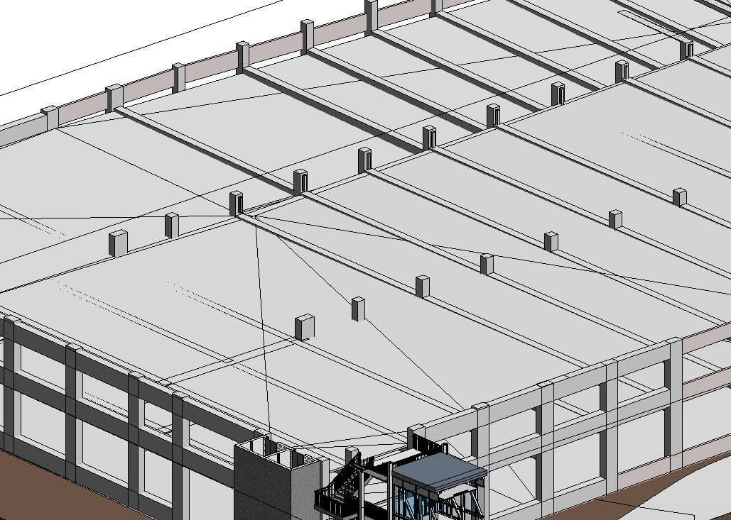

Hi,
i am doing a parking garage in revit 2012 with sloped floors and I have been trying to figure out how to connect a concrete beam to a concrete floor slab so when i changed the shape of the slab the beam follows the slab.
any help on this would be great.

"floor slab so when i changed the shape of the slab the beam follows the slab"
You mean change elevation of the slab or change thickness of the slab?  You would use a reference plane and set your floor and beam on the reference plane so if the reference plane changes the floor and beam will follow.

thanks for the reply,
i think one of the problems is that i have a slab that slopes in multiple directions therefore the beam does not have a common reference plane to host to. i would like to place a beam and it be hosted by the slab and when i change the elvation or the thickness it would respond accordingly
