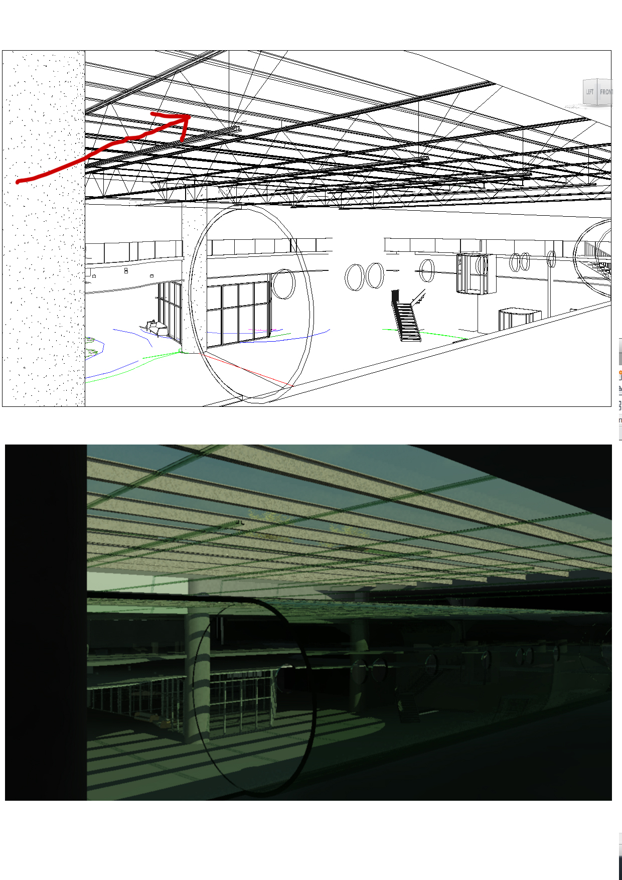

Hello and good day. My problem is: I am using DLH-series bar joists as a structural trus. It is visible in 3d, sections, any view before rendring, but when I render the members of the truss dissappear and u can only see top and bottom horizontal members without  the web.
Attaching the image below. U can see that c-channels are visible but the lower trusses are not. Pls help

Try changing your detail level to fine

oh, so simple, but it works! I was trying to edit type and things like that. Thank you very much!
