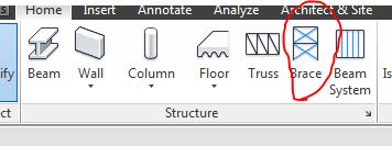

Right i want to show my vertical bracing a hidden line in plan view so i have edited a flat plate family by drawing a dashed symbolic line in its family. when i place the plate with start and end attachment level reference at 0 the symbolic line shows up but when i elevate one of the ends of the vertical bracing the symbolic line disappears. Is there a way to show my symbolic line when my one end of my vertical bracing is elevated higher than the other (as normal bracing is shown) ??? Thank you

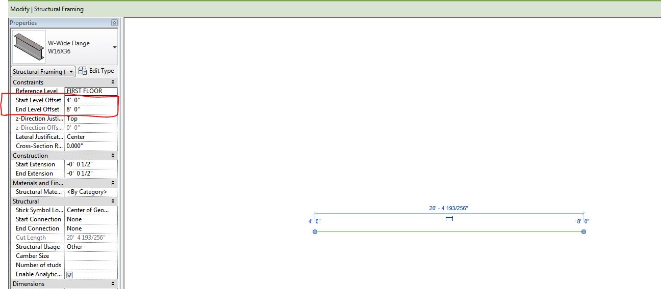

it looks like you're using beam instead of brace. see attach. and it will give you a solid line or dash line depending the direction its going (above level or below level)

You appear to be correct, if the brace is sloped it will not show in a plan view.  However I'm curious to know why you are using the bracing command to see things in a plan view? This function should be used for primarily elevation views, everything else can be done as a beam
