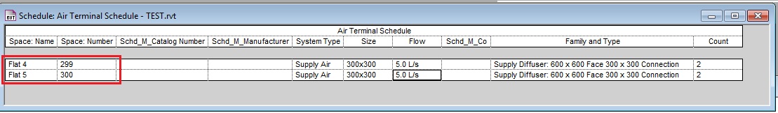

I think associate maybe the wrong word.
Within the schedule within revit it shows the room and flat these parts are in.
See jpg attached. The physical family doesnt actually know its in that room or should be in that room.
Fri, May 31, 2013 at 8:37:55 AM | Creating a content checking within each space created
So supply registers do show their rooms.  I know that Mechanical louvers will not because they are really not in the room - just through the wall.
