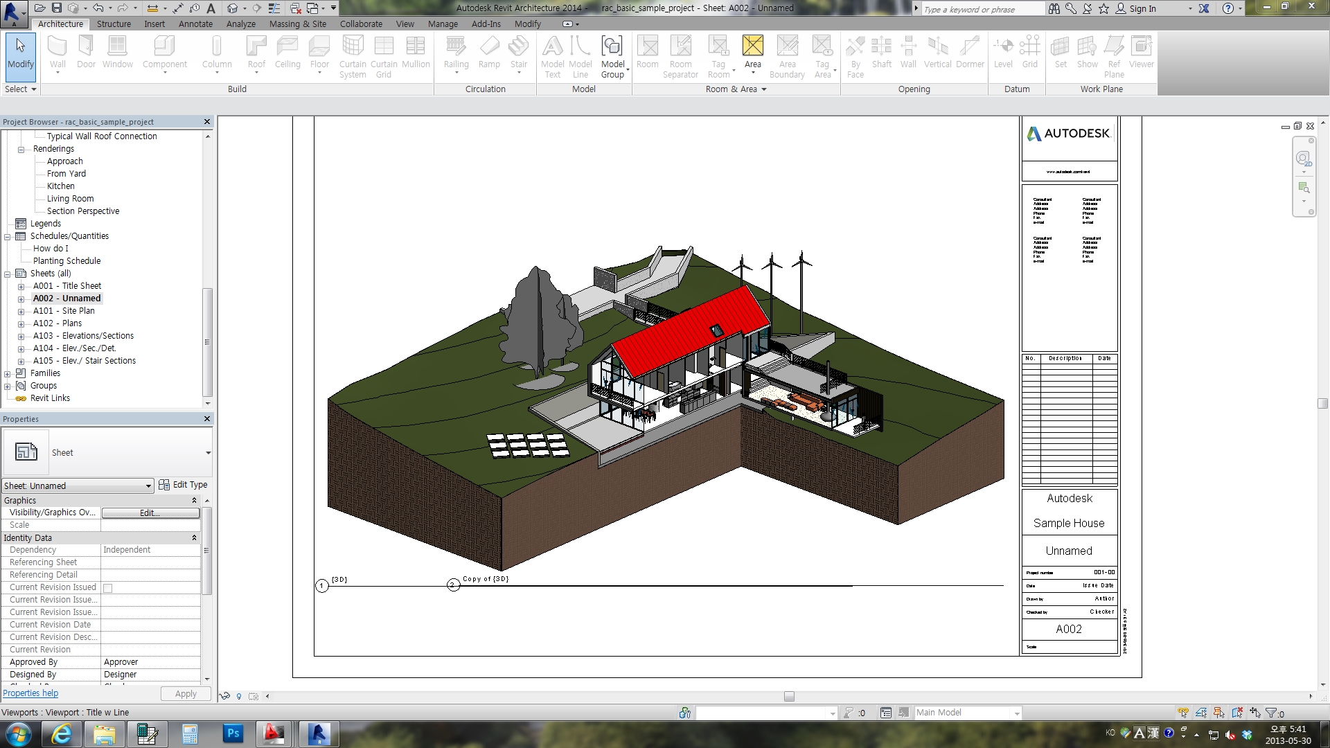

Thu, May 30, 2013 at 3:43:16 AM | Section box which is not rectangular
dingohot
dingohot Avatar
Joined: Mon, Mar 15, 2010
199 Posts
3.5 Stars: 5 Votes
and here's a sample i just made for you...Smile

Thu, May 30, 2013 at 3:55:57 AM | Section box which is not rectangular
Beaucoupnice
Beaucoupnice Avatar
Joined: Mon, Nov 19, 2007
93 Posts
3.5 Stars: 6 Votes
Yep - spot on

Mon, Jun 3, 2013 at 9:30:43 AM | Section box which is not rectangular
#9
danezeq
Joined: Fri, Apr 5, 2013
78 Posts
5 Stars: 1 Votes
is it HAS to be done using SHEET only?
i still dont get it how shuld it be done.
Mon, Jun 3, 2013 at 7:55:50 PM | Section box which is not rectangular
#10
Beaucoupnice
Beaucoupnice Avatar
93 Posts
3.5 Stars: 6 Votes
It cannot be done the way you want. Im sorry.

Mon, Jun 24, 2013 at 7:55:19 PM | danezeq
#11
dingohot
dingohot Avatar
199 Posts
3.5 Stars: 5 Votes
Quoting danezeq from 2013-06-03 09:30:43
watch this
http://youtu.be/2DW-DfF7bjw

Mon, Jun 24, 2013 at 8:15:54 PM | Section box which is not rectangular
#12
danezeq
78 Posts
5 Stars: 1 Votes
thank you
my problem is the the intended complex section is designated for RENDER - and rendering a sheet isn't possible.
what is more, the disired section is more complex and perspective so i tried your trick and it look like 3 copy-pasted sections while the transition between them is un natural.
