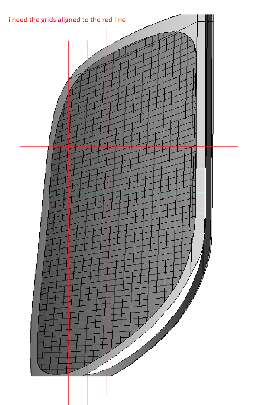

Hi,
I picked the face of a imported rhino surface (.sat format) to create a curtain system in Revit. But the curtain grids are not aligned by horizontal or vertical. Any ideas ?

import the model without grids if possible, then make grids in Revit.

finally it is fixed....very long procedure
Main thing is we need to create new surface based on the existing surface by horizontal and vertical curves in rhino.
