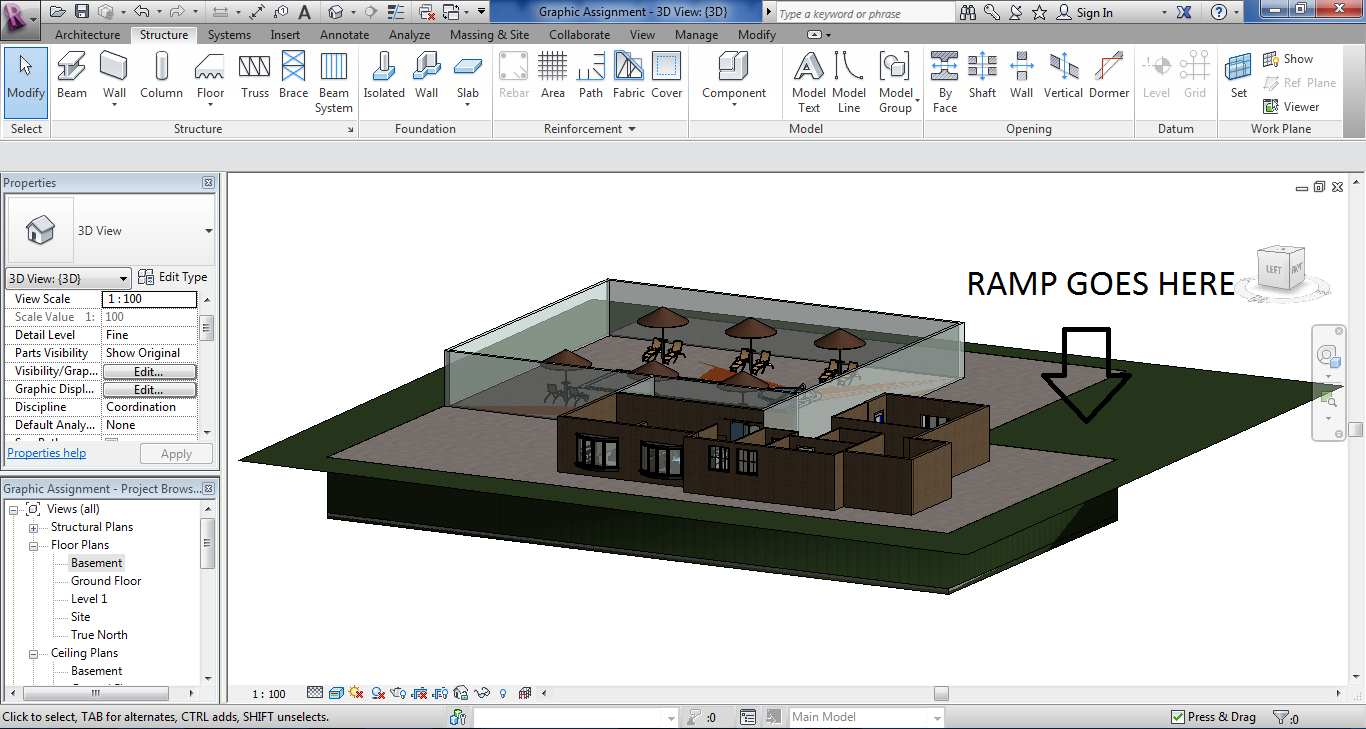

I'm trying to build an underground car park but am having trouble, could you please help me? So the plan is that it's an underground car park under a house (Yes, I said an underground car park under a house, but more like a mansion). So I've made the hole in the ground by doing the building pad and I've also made a floor plan called "Basement". I just need to know how to make a ramp going up to the "Ground Floor" so that the cars could obviously get out. Also, does anyone know how to make Revit only see the "Basement" and not the "Ground Floor", as I can't see anything.
In the following picture the pool is covered by the slab. How do I fix that? Also, is the Building pad in the correct place to make the ramp? Please help me!
Thanks.

It obviously doesn't look like a mansion now because I haven't completed it but the aim is to make it a mansion. Puh

Make two topographies.  Add a ramp to the one you have.  Then add a new site sketched around your upper structure and  just over your pad area.  And read this: http://www.revitcity.com/forums.php?action=viewthread&thread_id=11258
