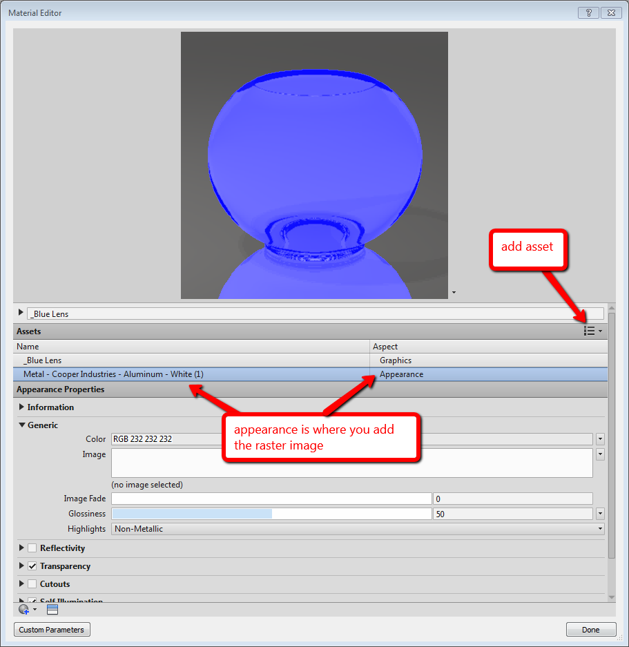

does your material have the asset for "appearance" in the material editor?

Thanks!  So this is how I ended up doing it.  Duplicate a material that already has a raster image associated with it.  Click on "Appearance" as shown in the image above.  Click on the .png file name under the thumbnail image and select the custom .png file that you saved to the following location:
C:> Program Files (x86) > Common Files > Autodesk Shared > Materials > Textures > 3 > Mats
I'm not sure this will be the file location for everyone but you can quickly figure out what it is by clicking on the .png file under the thumbnail image and it will take you to the destination folder.
One note:  I was not able to save the .png image to the destination folder directly from Photoshop.  I had to save it to the Desktop first and copy it into the desination folder.  It will tell you that you need permission from an Administrator but I just clicked "Continue" and it copied just fine.
Hope this helps anyone who might have this problem in the future!

In Revit 14
First select a plain material like : Laminate Ivory Matte.
Then under appearance select image....browse your image...adjust the required sample size
and apply
