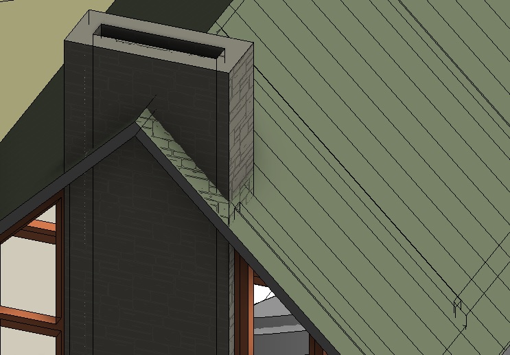

I'm trying to do a simple rendering for a client but for some reason where the roof is showing the chimney material where it passes infront of it. Its also showing some lines behind it where the walls are. Is there a setting that i have set thats allowing this to happen?
I attached an image of what the issue looks like. It happens with some walls showing some lines of objects in the room too.
Thanks

This may be a graphics card issue.
Make sure you have the latest Revit build, the latest drivers and you may want to switch off hardware acceleration - under the revit R pulldown / options.
