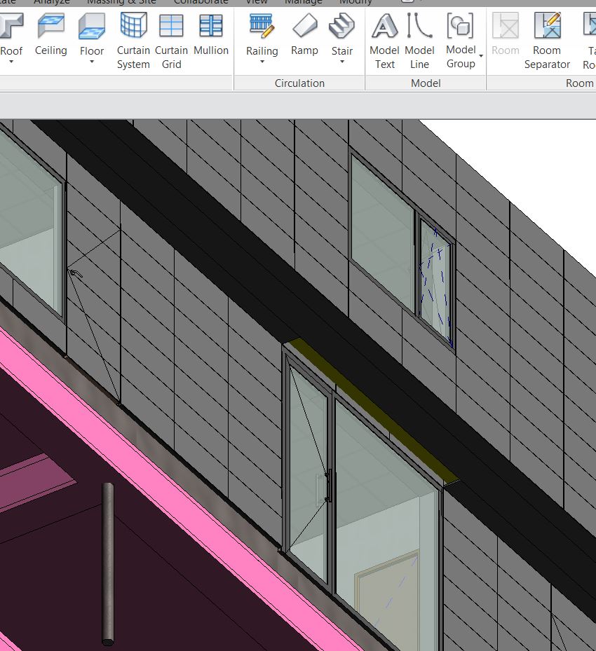

Hi,
I have a problem with Revit above the entrance door. The door cuts the floor above. I have added a picture of the problem. How can I solve it?Thanks for your help.Hamed

You have to edit that family and check if there is any VOID cutting that portion of wall...

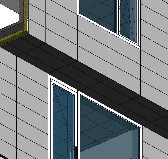

Hi Typhoon,
Thank you for your reaction. The problem was actually a wall sweep above de door family. I have replaced it wiht a geric model and as you can see it works.
