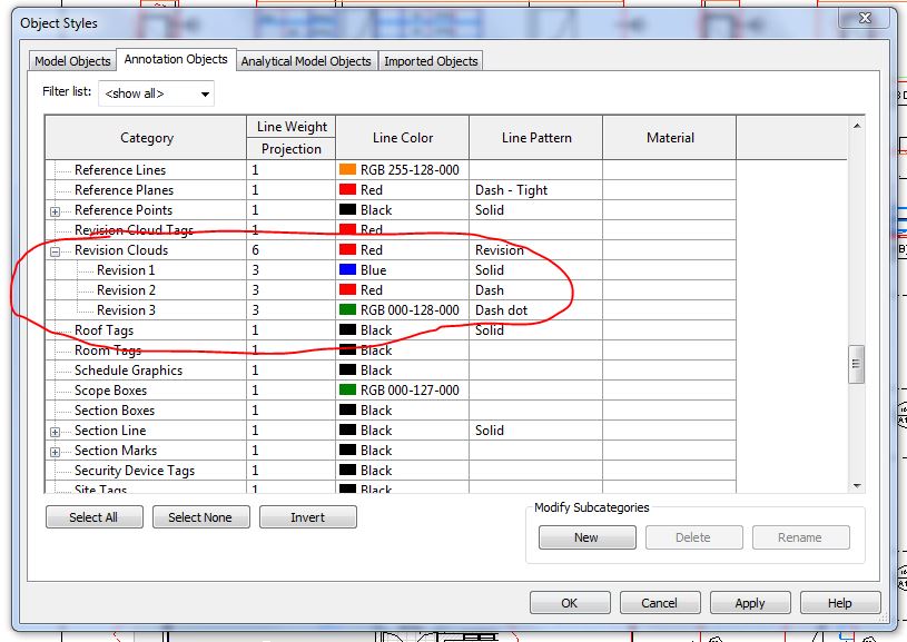

I've just realised I can add "subcategories" to the Revision Cloud Object Style, however I'm not sure how to actually assign these to a revision cloud ??
Not even sure if this can be done or if I'm just creating object styles for no reason.
Refer to attached

Raja15, did you ever get a solution for this, working with object styles?  We like to have the latest revision clouds and tags colored as red so it stands out and all the other previous revsions go back to black.  Having to override graphics per element will seem to be to time consuming and prone to error. I have not worked with filters at all other than trying to figure out what they are useful for but seems they might work for this problem.

hanbyjm - sorry no we never resolved this issue. From memory I think we had to individually override each cloud as mentioned. Another work around is using the revision cloud tags to categorise but you don't get the visual difference in items as you would with colours. Maybe still an item for the Wishlist in the future!
