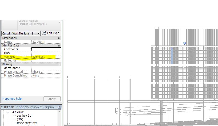

and another thing
it's impossible to take part of the model and move it to another workset  AT ONCE (one selection) like in this video
http://www.youtube.com/watch?v=wVT74tW2zn0 Cryinggo to 5:30)
beacuse when i pick elements that include wall mullions - it not letting me change the workset (the line WORKSET is getting grey at properties window)

I dont think you understand worksets. Look in your HELP for an explination. Worksets are always in the project but you can turn them on and off as you need

Sat, May 25, 2013 at 1:28:15 PM | large scale projects in REVIT
#12
You need to read your HELP on work sharing or you will never get to where you need to be.
READ IT - then come back if you have problems.
