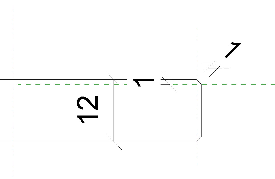

Hi,
I am trying to extrude a glass panel with chamfer edges.  However i want it to be parametric, so i can change the thickness of the glass panel.  When i add a parameter for glass thickness and increase the thickness, the chamfer edge angle and size changes.  I want to retain the chamfer angle and length fixed.
Can someone please advise... I have been trying to solve this issue for hours.  Also, i want to load it into a Curtain wall panel family... Should i extrude it within the curtain wall family, or should i create it as a separate family (if so, which family?) and then load it into my curtain wall family?
 Thank you.

Download and read the "Families Guide" from the AutoDESK site.  It will show you how to constrain geometry like this .... and MUCH MORE.
