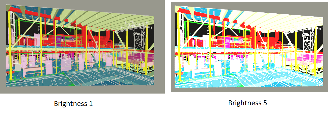

hey everyone :-)
i just find the way to import JPEGS inside revit. i do it thrugh INSERT>>DECALS.
i saw inside an option to make the jpeg iluminate like lcd screen. i did choose this option but then i didn't see it iluminated in the final render.
was i supossed to render with artificial lights to see the renders iluminated?

Once you set the Decal to Luminate then play with the 'brightness' setting. See image.

thank you iwill try.
btw it doent look like LCD lighting. only more bright image.
