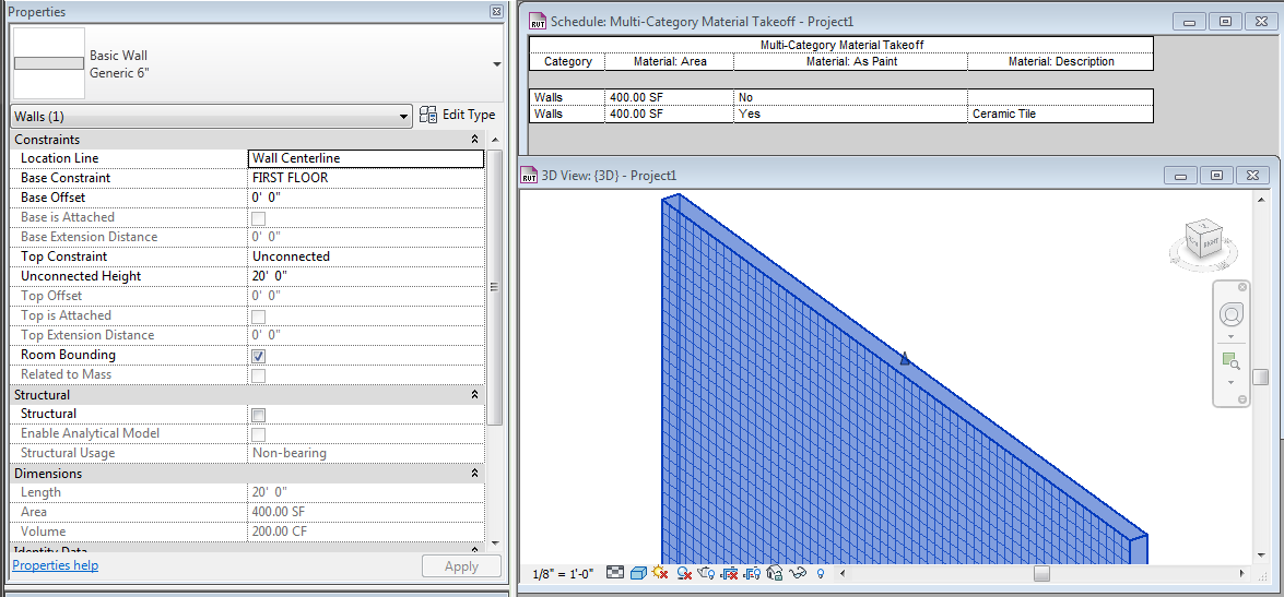

You are incorrect.  Paint is not just for visualization!  It changes the material in the project and will schedule under material takeoff.  It will not change how, say a wall element, will show in section view.
Note that in a material takeoff, you can show if the material was painted or not.
