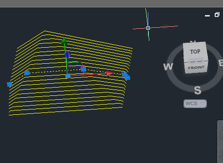

I have created a topo surface in Revit by manually inserting 3D points.  Is there a process to export those 3D points to a DWG without the TIN surface.  We need to import the points into another program that wants points or contour lines, not a TIN surface.
Wed, May 15, 2013 at 9:42:15 AM | Exporting topography points from Revit to AutoCad
Did you try exporting a 3D site view to CAD?  That will give you 3D CAD.
Wed, May 15, 2013 at 9:51:39 AM | Exporting topography points from Revit to AutoCad
hlmckinney
Joined: Wed, Aug 1, 2007
2 Posts
Yes that is what I did.  I need to clarify my initial post.  The export created a polymesh surface in AutoCAD, not a TIN.  I need to be able to isolate the 3D points or convert the polymesh surface to a TIN or 3D topography lines.
Wed, May 15, 2013 at 10:05:33 AM | Exporting topography points from Revit to AutoCad
If you have your contours on in the 3D View, they export as well and are seperate from the surface.  Works for me.
