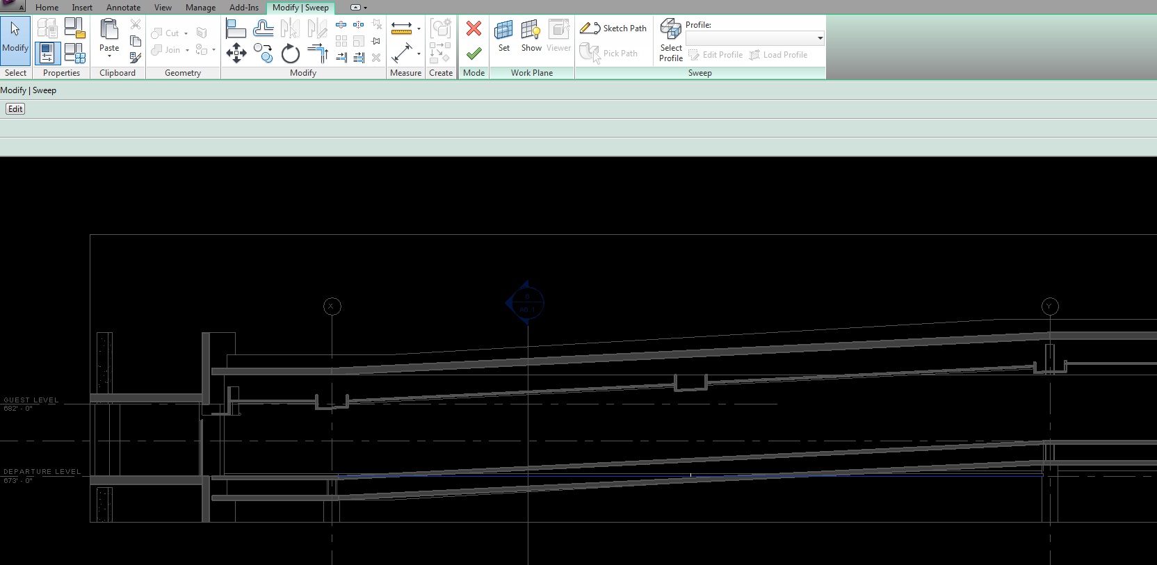

I am having some trouble finding the right way to accomplish this wall base (see attached image), aside from detail lines - using Revit 2012.  I've tried an extrusion, but can't slope it (if I did it right).  I've tried creating a wall based, and floor based wall family.  Any tips or tricks?  Thank you in advance.

Put a reference line at the desired slope area and use that as your reference plane for your in-place sweep
