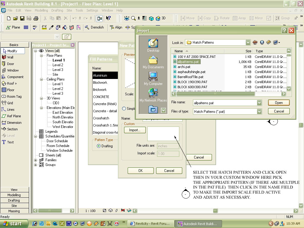

Refer to the attach pic it should explain it easier. Settings-->Fill Patterns-->Drafting tab-->New-->Pick the custom check-->Select Import-->Find your pat files and pick one-->Select one from your import list if there are multiple in that pat file-->click in the name field to activate the scale field-->adjust the scale as necessary and then okay out of the command. HTH.

Thanks Mr Spot, it worked that time. I don't understand why I wasn't able to fix the scale when I reloaded the pattern the first time, but I could do it the second time. I guess that's part of learning the quirks of Revit. I appreciate the help.
