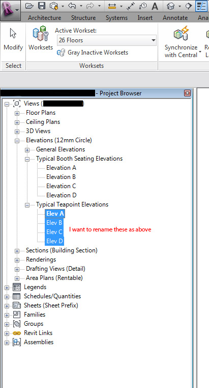

Greetings,
I have an office fit out job and am setting up seperate sheets for each area that needs detailing, ie; Staff Kitchen, WCs, Meeting Rooms etc.
Now for each room there will be 4 elevations and I'd like to be able to maintain a sensible naming discipline, ie; Elevation A/B/C/D etc. However when I try to rename a new set of elevations for a different room Revit (Arch 2013 ) tells me that the view name is "already in use and to choose a unique name". I can rename the name of each elevation view by adding the room name to make each view unique, but this makes the title long and very repetitive especially when you have 4 elevations on one sheet, the client does not need to see 'Kitchen elevation 1.....Kitchen elevation 2 etc when he is already looking at the kitchen drawing sheet. I have played around with adding a project parameter and organising my project browser (as attached image).
Any ideas on how I can have 'Kitchen Elevations A,B,C,D' and 'Staff WCs Elevations A,B,C,D' would be appreciated.
Many thanks,
CM.

You cant have the same VIEW name in your project browser however if you click on the view and look in your properties you will see a Title On Sheet section and you can name your view whatever you want on the sheet.

I see, thank you very much for the tip and for the quick response.
