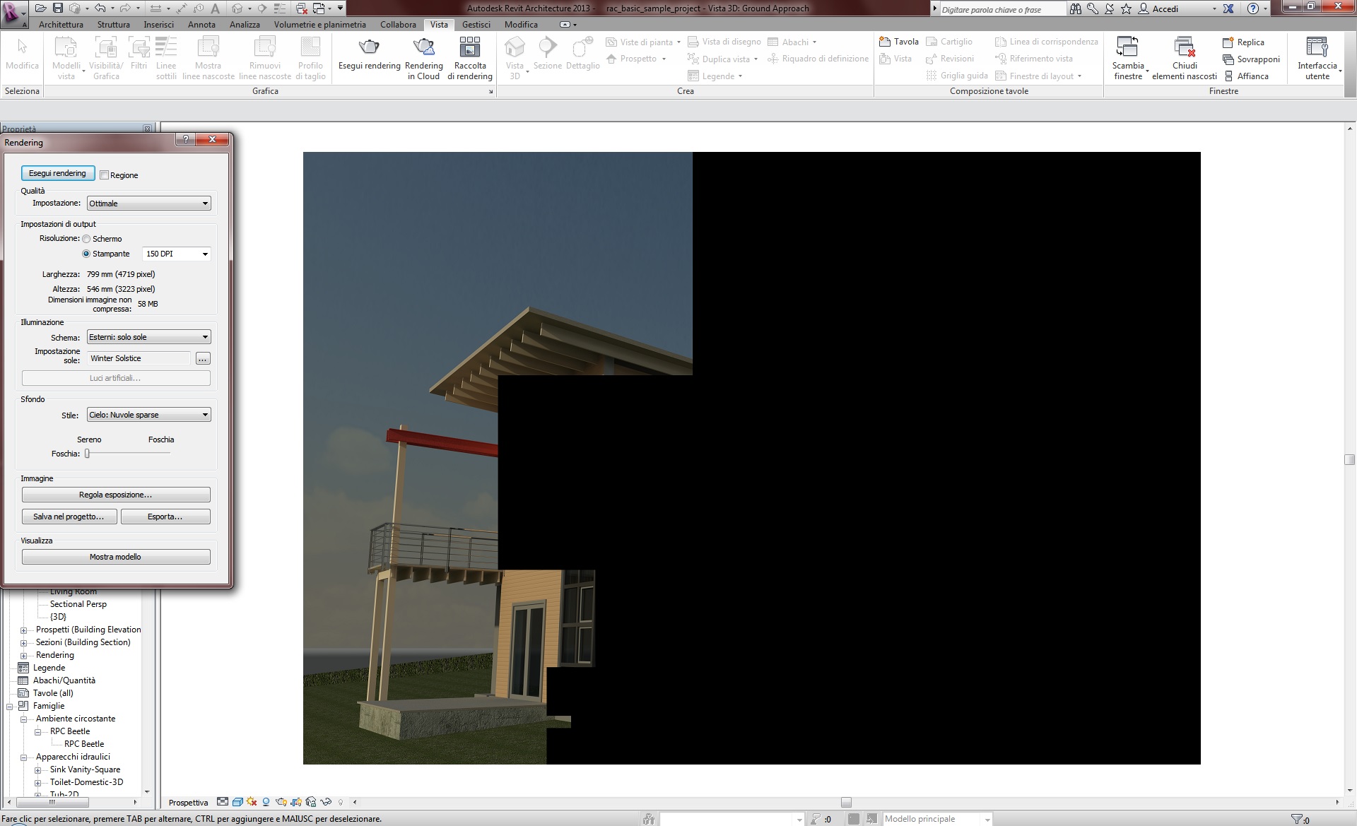

Hi at all, have this strange issue: installed revit 2013 and as usual try feature with example at first screen. Open arch house, in 3d view memory of my GTX 580 bumps up to 1500mb! never seen! it's a simple model, not too big.. so check options and uncheck antialiasing so video memory goes down to 400-500mb. but quality it's low. by the way.. it's necessary. But render is the problem, open one of 3dview into project that already exists: outside only sun, medium quality, print 150DPI. after 10minutes it's at 75-80%, revit is rendering textures.. suddenly stops! image is squared, partial completed but not all!!! what's wrong?!
PC specs:
i7 950 - GTX 580 1.5gb - 6gb RAM - hard disk

Autodesk 360 might be albe to help you with getting your renders if its urgent. You can upload your model and do the renders via 360.

it isn'urgent but.. how you see in the picture 1 the render isn't complete! can't understand why.. and where find solution. i come from revit 2011 that worked like a charm and upgrade for new feature and functions. probably will stay with 11

Do you have the latest build for 2013?  The rendering capapilites from 2011 and 2013 are the same.  2013 has a lot more functions to offer than 2011 so I would suggest upgrading.

i don't have installed updates.. take a look and try to install service pack, will report if solve problem.
