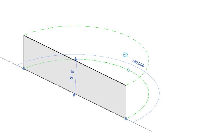

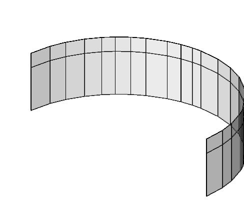

When you change your wall to a curtain wall it is going straight because you cant have a "curved" curtain wall, you will need to add your grids to your curtain wall at the spacing you want and your curtain wall will update to the curve you need (see attached images, one without grids stays straight but has the curve properties and one with grids changes the curtain wall to follow the curve)
