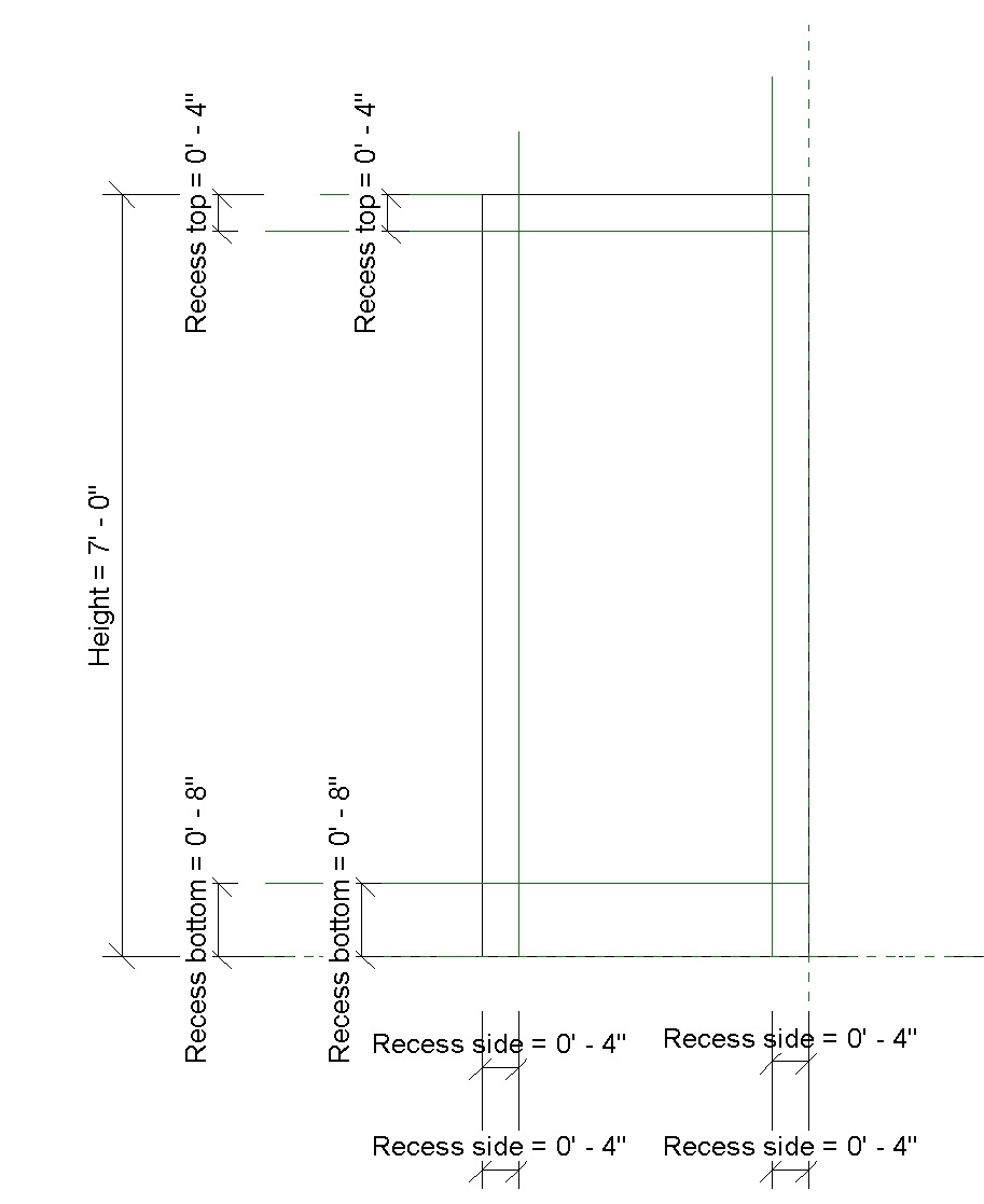

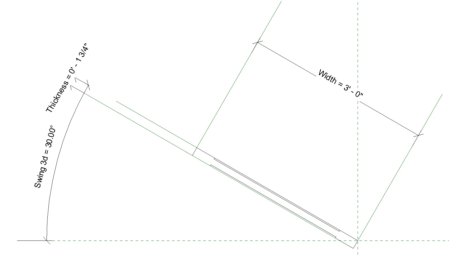

I finally made a 3d door panel with parametric swing, which took moe several nights. Now I am trying to create a nested family. But once it is imported in a parenty family. It gets bad. Everytime the swing angle chagnes, the width of the panel will change, which doesn't happen in its own family edit mode. It happens both before and after it shares parameters such as width and hegiht.
Two files are attached. One is flush, and the other is a recessed panel. I also had to spend another several nights to figure out to have both the panel and void (for recess) swing together. It also works fine until it is imported to a parent family.
Ps. in order to see if it's going to make differences, they are constructed in a slightly different way with reference planes. Unfortunately, both just don't work in a parent family.

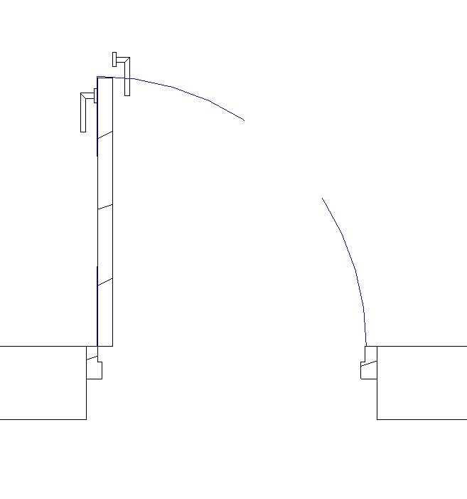

Hey!!!! I'll help you out. Unfortunately I'm still using revit 2012 so I cant open your family. Take a look at the door family I've attached though it has a parametric swing. Try sending clear Jpeg images of the door's plan, elevations and sections showing the reference planes. I might be a ble to spot your mistake. Hope to hear from you.

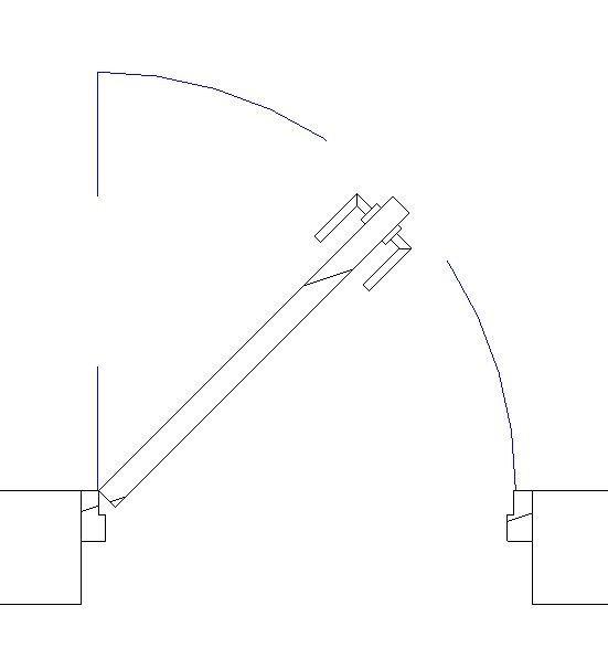

Thank you very much. I tried the door you uploaded, but the door handle gets separated from the door at 90. (I guess the 2d line is supposed to stay at 90 when the 3d door is at another angle.) Please refer to 1, 2.jpg for this.
What I have been trying to do is, have 2d door and 3d door(hidden on orthographic views) swing separtely. Another thing I am tyring to add to this is, usuing masking region not just 2d symbolic line so that it can cover floor finish pattern on plan. My test files don't have masking regions yet since I couldn't even get 2d lines/3d door to work.

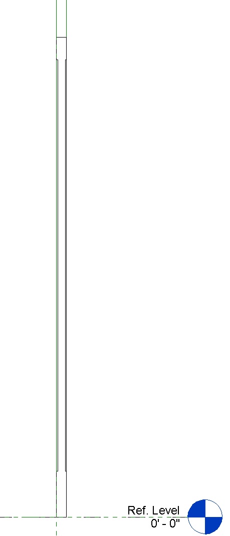

The attached Plan, Elevation, and Section.jpg are screenschots of one of the door panels that I uploaded. This swings fine on its own, but when I try to insert this in a new door family, the whole thing gets messed up. I am using reference lines for swing, which many tutorials I found say I need to use. (Eventually, I will want to use both a 3d door panel family and a 2d door line family in a new door family for separate 2d/3d swing but coordinated for other things such as size)

The door handle moved in my family because it wasn't locked properly. Take a look at it now. Please can u give a clear step by step explanantion of your modelling process???. This should help me in highlighting your mistakes.

Yes the door should be a faced based generic model :-). See why I need your modelling process. The faced based generic model should then be placed on a reference line in a door family. The large thing beneath the door represents the face of the reference line.

Err......I see what you are trying to do but I just don't understand why the door has to behave differently in the different views. I don't see why it's a problem if the door is slightly open in perspective and this reflects in plan also. Just change the door swing parameter to open the door wider when needed. I dont really get wht this worries you.
Conventionally door swings are shown to their full extents. I don't see the point in changing such a convention. Just draw a symbolic line to show the full door swing and model the door with an angle parameter as I have described.
If you still want to go foward with your idea. I would suggest that you create a generic annotation family. Generic annotations are only visible in the views they are placed in. Nest this generic annotation into the door family making sure it also has the parameters that the door has.
