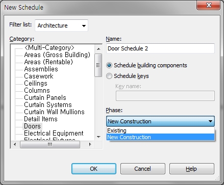

So I am finishing up some CDs and just put in my door schedule and ran into a problem.  This is an interior renovation job and we are taking out all the existing walls and doors and putting in all new walls and doors... Problem with this is the fact that my door schedule is only showing the demolished doors and none of the new doors. I changed the phasing for the door schedule to every single possibility and checked all the interior doors and they are all new construction created.... What could be wrong?  What am I missing?

you have to select phase when you start to make a schedule
see attatched image
