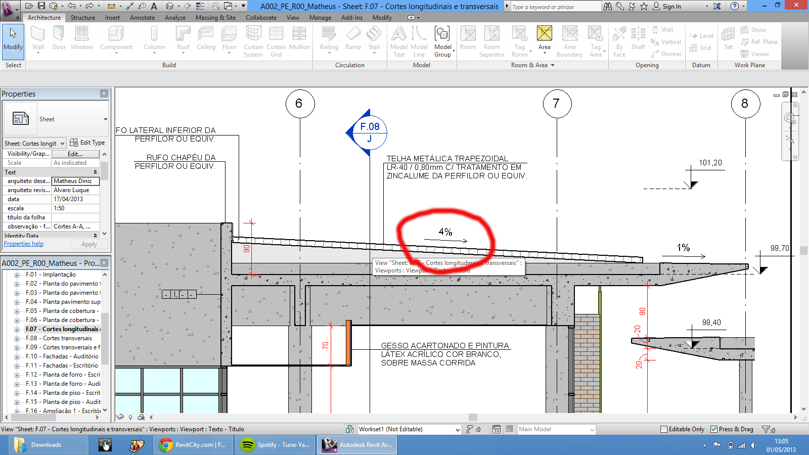

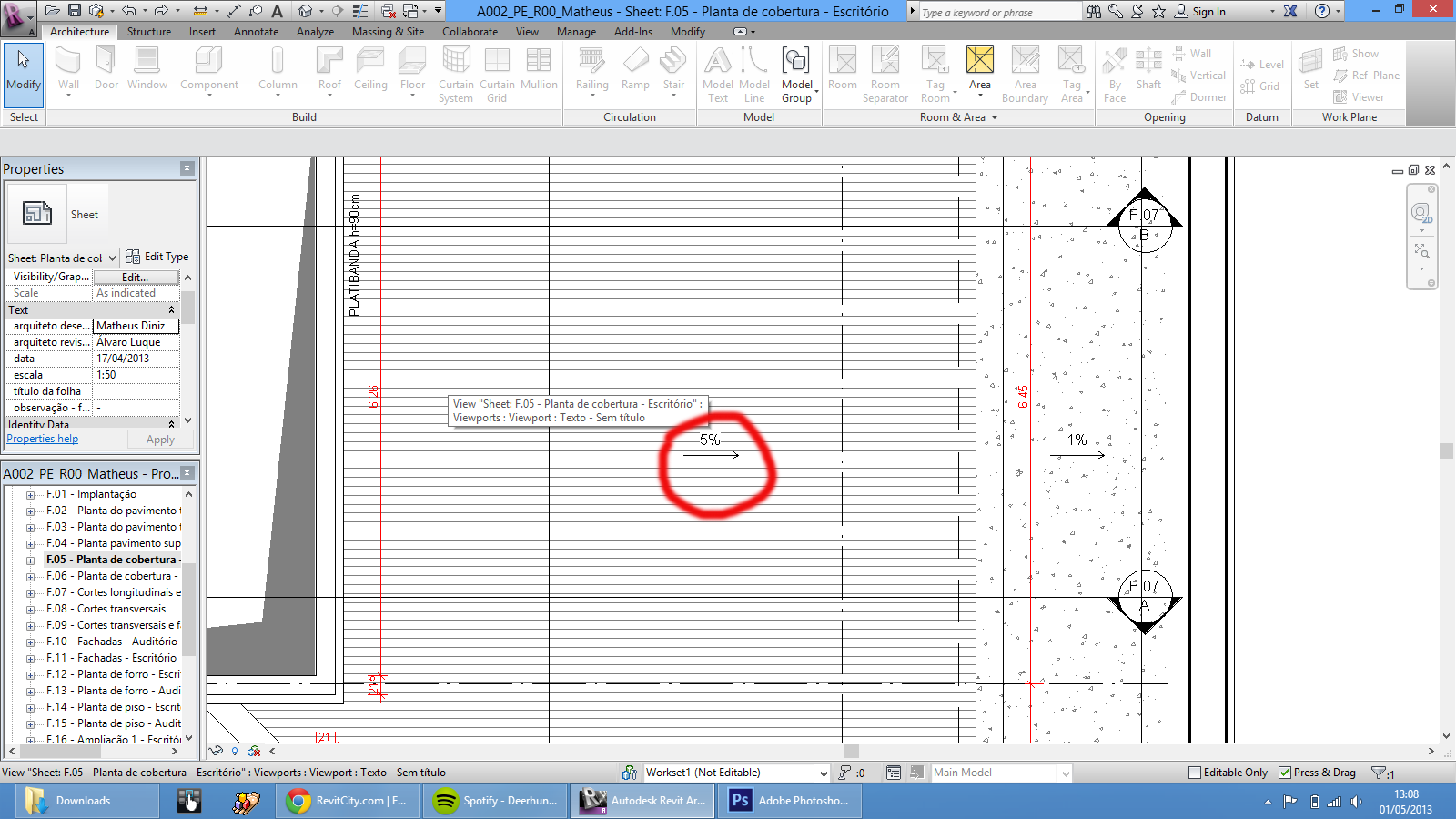

Hello,
I am having some problems with the spot slope annotation tool. the same roof is displayed as having 5% slope in plan and 4% slope in section (even though the section is parallel to the slope). I constructed it with 5% slope with the roof tool.

Your using the same tag in both cases?
Check your units (in the tag- they can be different than the project) - see if this is a rounding error.

Are you sure you have selected the right object?

Typhoon, you solved my problem, i hit tab and it changed to 5%. I never thought it would go first to something that was not even cut by the section plane. I think it selected the joint between the two roofs. Crazy Revit...
