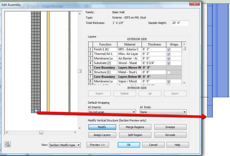

I need to extend the exterior cladding past my foundation wall.  I know I can call this out in detail. But I wish to show this in my 3D model.

Unlock it in the wall properties and Extend it in the model

Thanks, but I tried that and it is not working. Any other suggestions

Step by Step. Click to View:
https://chronicle.autodesk.com/Main/Details/3fd9b539-0c45-482a-a630-90ab4a3c3ab4
