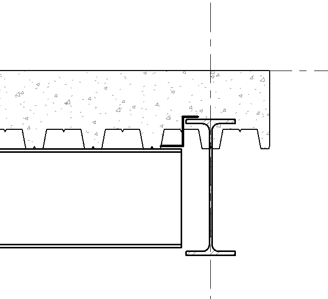

Hi,
I need help with cutting out the section of the floor slab at the edge. In the picture, you can see how the slab is going through the beam. Well, we want it to jag up just at the edges and sit on top of the beam. What is the best way to do this? I was just going to mask it all, but that is time consuming. Thoughts?
Fri, Apr 26, 2013 at 7:43:46 AM | Cutting out section of floor at edge
I would just use edit cut profile in that detail.
Fri, Apr 26, 2013 at 7:48:36 AM | Cutting out section of floor at edge
sblake
Joined: Tue, Jan 24, 2012
38 Posts
Thanks for the reply.
When I go to the cut command, it asks for a family to cut with? It won't pick the beam, and I tried a reference line as well.
Fri, Apr 26, 2013 at 7:56:16 AM | Cutting out section of floor at edge
sblake
38 Posts
Ok. I got it. I was using just the cut comman, not the cut profile. Thanks!

The edit cut profile is a great toool  - learn to use it and you will use more of your model.  The ONLY problem is the cut-profile lineweight is not definable.  Hope that is fixed in 14.

Also remember cut profile is view-specific. It does not actually alter the model element.
