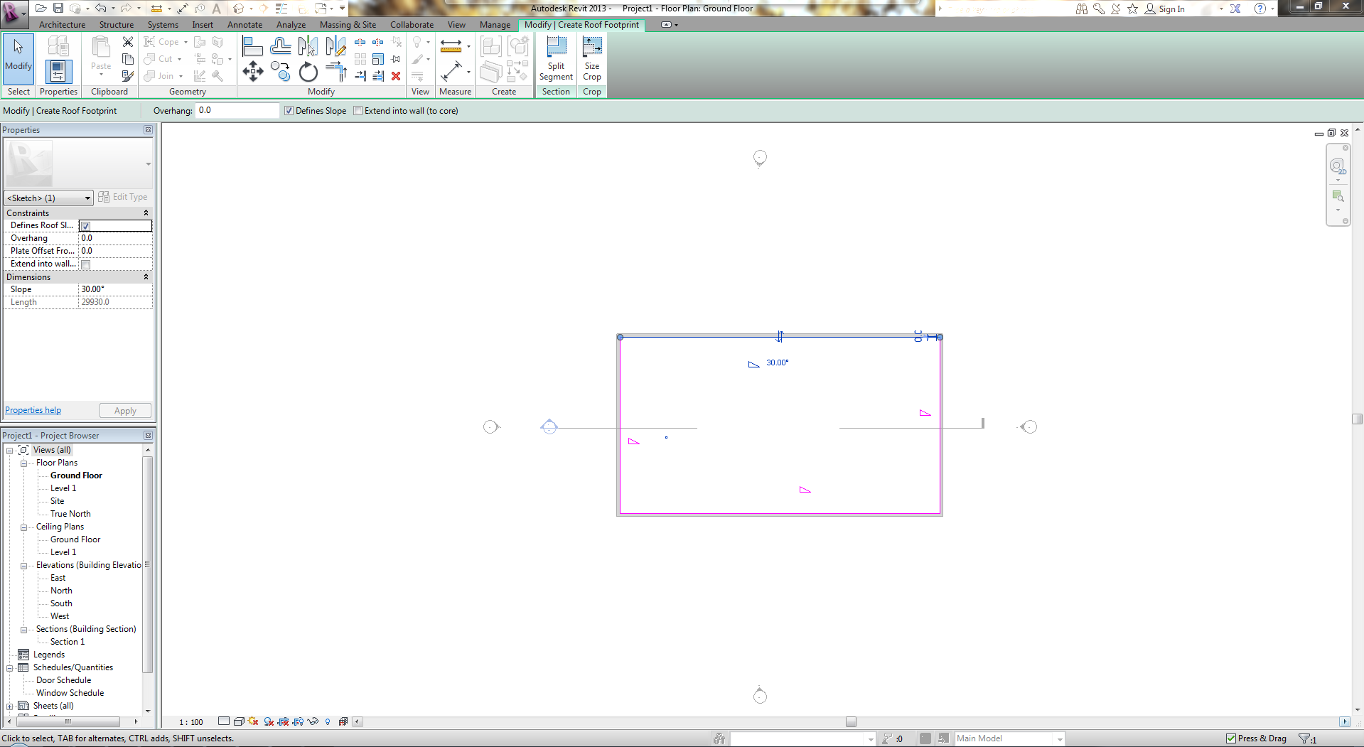

hi, i have reinstalled revit several times, also following the steps for a clean install.
the issue is that for example when i want to edit or create a roof it doesnt have the finish or cancel button, no matter if its an existing proyect or new. this also happens if i want to edit any other object.
the issue started after trying and failing to install revit 2014 trial.
the attached image is an example of creating the roof without the finish or cancel button and its driving me crazy because i cant work on my projects.
i really appreciate the help and thanks in advance

This is due to new software install by trying to install Revit 2014. I think it's the .net stuff. If you were using Revit 2013
you have to make sure your are on latest build of Revit 2013 now also.

i did install the latest update when revit was reinstalling and still dont know what to do. revit 2014 was never able to completely install

Revit 2014 is a bear to install, you may have no other option at this point. I don't have Revit 2013 installed any more
and do know what the latest build is to help you verify. But I am told this problem is due installing Revit 2014 and
Revit 2013 on the same machine.

i try that just like it says there and still have the same issue...
seems that i will have to try and reinstall 2014 instead
it also messed up my Autocad2013, i just opened it and it is asking for the cd, so i guess ill have to reinstall that also
