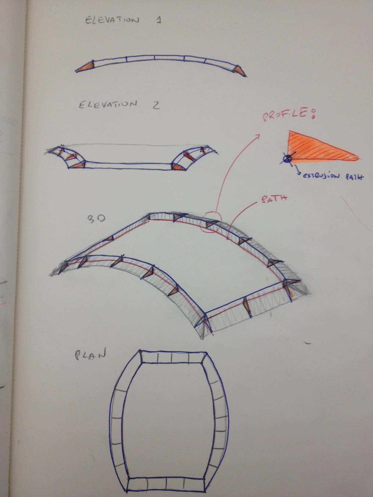

Hello,I would like to creat this 3D roof geometry, but I don`t know which is the best way of doing it?
The roof edge is curved in plan and in elevation.
I would like to "extrude along path" the edge profile.
what is the best way?Thanks

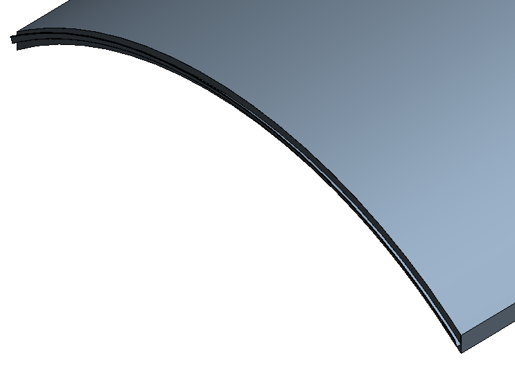

It is a "Sweep" ...."along the edge"..not one command... Do a sweep and pick the 3dEdge as the path.
Attached is an arched roof with "gutter" along the arched edge.   It is a gutter profile but the usage was changed from gutter to facia.  The facia profile can be used along any roof edge but a gutter can only be used along a straight edge.

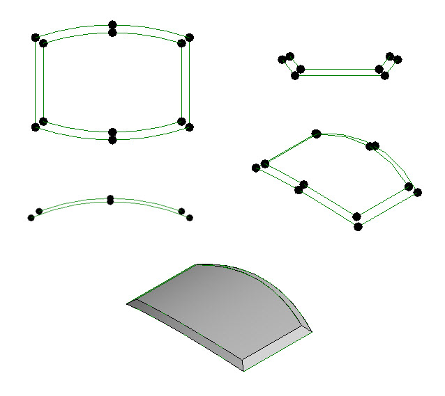

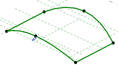

In a generic adaptive template, use reference splines for the curves, and reference lines for the straight edges. In elevation, use named reference planes to change the host of the points. Then select the two curves, and do "Create form".

The problem with that is that I need to then draw 3 edges.
And how can I do it isint the extrusion profile along the edge?
In this way I coild control the profile...
