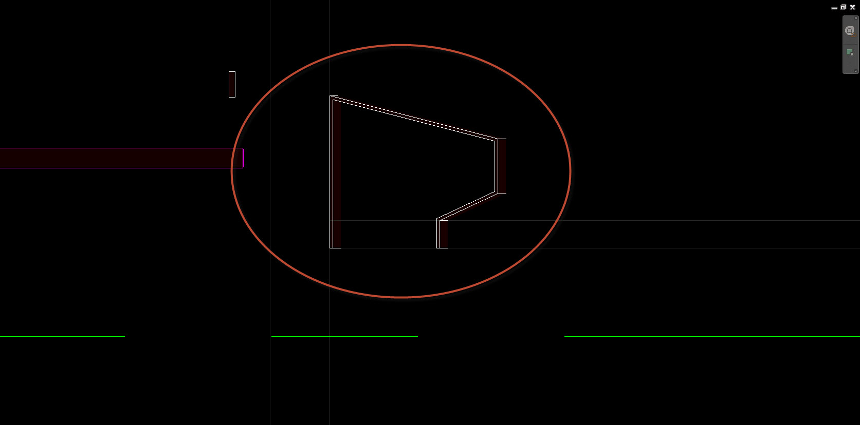

Would anyone be able to explain how to create a custom light fixture that is hosted to a linked architectural model. I created a custom light family and tried the "cut with voids tool". It doesent seem to be cutting through the cieling it is hosted too. If you need more information, please let me know. I will respond immediately. Thanks
Tue, Apr 23, 2013 at 11:09:03 AM | Custom Light Fixture
No family can cut a linked model.  Both host and family has to be in the same model.

Darn, so how would I go about keeping a light fixture in the MEP model and being able to show up correctly in the Arch model with cutting a wall or ceiling.
Tue, Apr 23, 2013 at 4:33:18 PM | Custom Light Fixture
dgcad
dgcad Avatar
Joined: Thu, Mar 17, 2005
1231 Posts
3.5 Stars: 36 Votes
Not pretty
You need to re-model the walls (copy monitor perhaps) and the ceiling (copy and paste) into your model.
One way or the other you can't cut a whole in a linked model.
