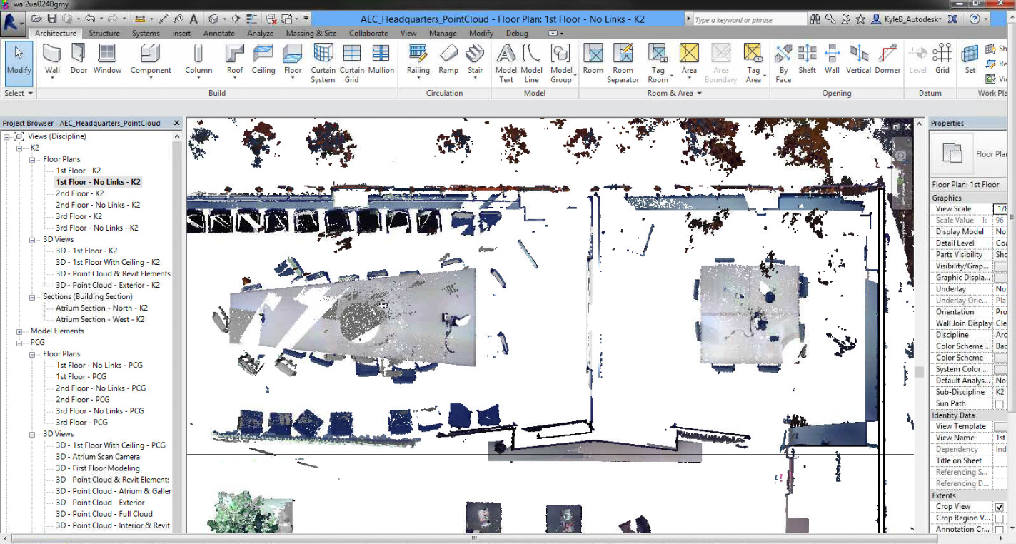

I did a shared screen with Kyle from Autodesk to review this issue.
He recommended doing an interesting trick that does help.
Change the view depth to be 3" or 4" above the floor and down a bit from the ceiling.  That eliminates some of the scattered noise in the image and the image did seem to sharpen up with more useful detail.
I'm still not seeing as much detail or color in the Revit version of the same point cloud in a 3D view compared to the same point cloud in Recap.  That's not supposed to be possible because it's the same image and the same point cloud engine.
Elmer Bol recommended using the default 2 Pixel resolution from Recap.
Kyle is downloading my point cloud and reviewing it.  More as this develops.
I have a Nvidia Quadro 4000 graphics card and 16 Gb of RAM running on Win7 x64.  I did notice that 32 Gb of RAM is recommended for the 2014 software....
I attached a screen shot of his screen that shows their office that was scanned with a Faro Scanner as well.

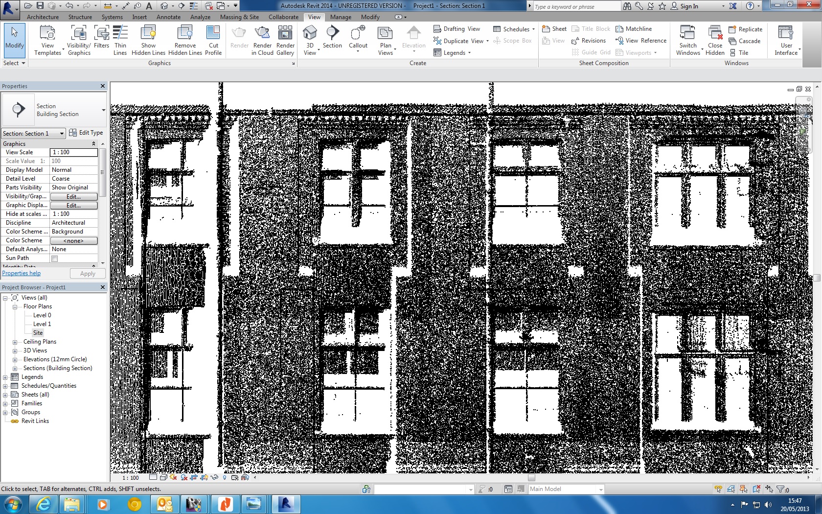

Okay I've done a little more testing and I think I've solved the resolution issue, well found a work around at least and the cause of the problem! As you'll see from the attached image I've managed to get the 2014 data matching closely to the 2013 in terms of point density.
One of my team recognised that the point pattern was very similar to an error that occured in Geomagic. very similar to how Revit has issues with things being too far from project base point so does geomagic. It turns out that even though I dropped the cloud very close to the project base point for some reason Revit 2014 must be still reading the old real world coordinates and sees it as if it is still 100s of miles from origin, which is what seems to be causing the resolution problems. Hence we went back into the original registered data in cyclone and made the project arbitrary (moved it close to 0,0,0), we then re-exported to .pts bought into Revit and the results are as per the attachment, loads better than before and deffinately possible to work with now!
And guess what, it even solved the intensity issue! For some reason it seems a bit jumpy while loading in but I'm just moaning for the sake of it now... I'm a very happy man Winking
Would be good to see things working without altering the native datas origin, but hey at least we have a work around now Winking
