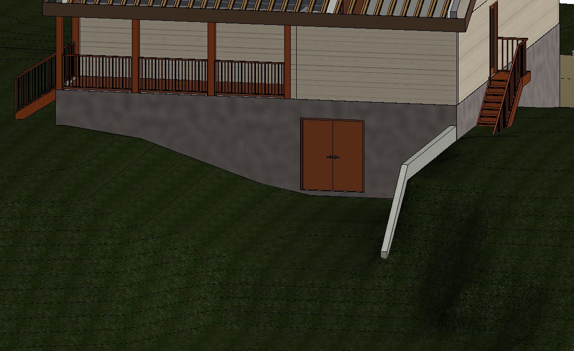

Gretings,
What is the best way to handle the contuors and required retaining walls on a sloping site?
I am sloping 2', need to cut out the ground for my doors. I thought building pad, but not working, started adding points to my surfaces but that is crazy work. I have not yet merged my surfaces....
thanks
j
Thu, Apr 18, 2013 at 3:29:12 PM | Revit 2013 - Sloping site & retaining walls
teafoe5
teafoe5 Avatar
Joined: Fri, Nov 12, 2010
1749 Posts
4 Stars: 47 Votes

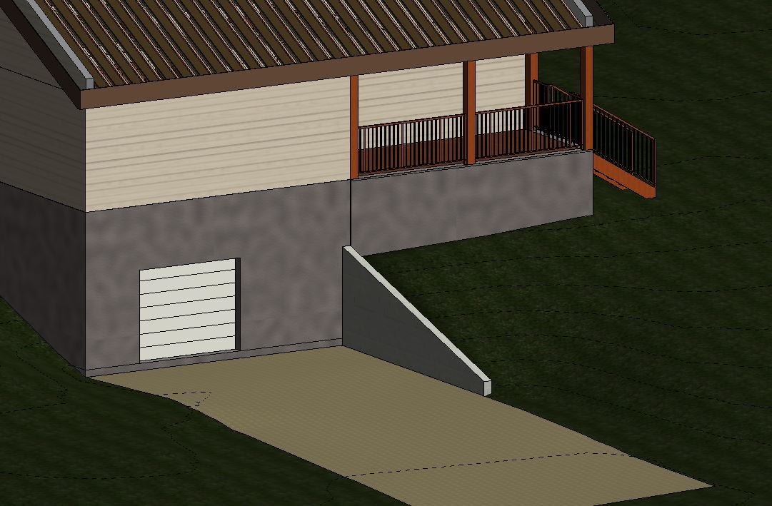

What do you mean its crazy?  See the attached images. I did that in about 5 minutes. No need for a building pad, you'd put the points like the would be in real life.

As teafoe says ... just add a point to both sides of your wall.  Then more in the field as required.
