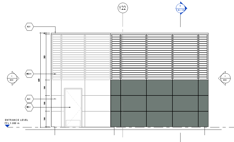

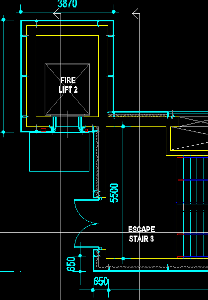

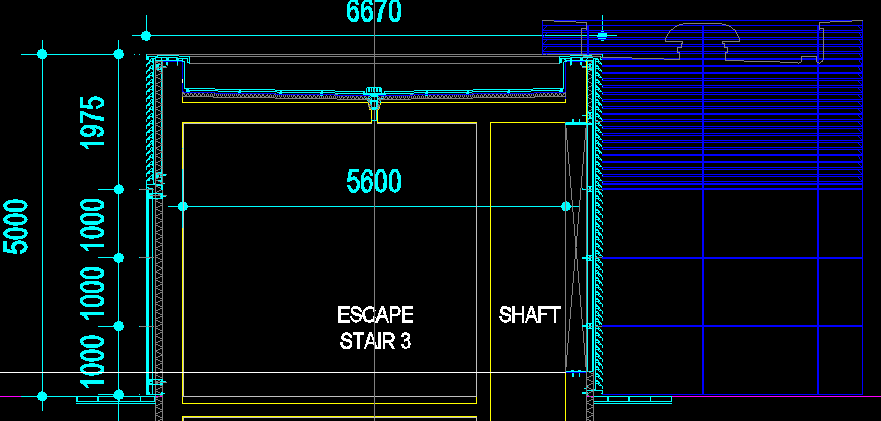

Hi,
Can someone here, suggest as to how i can achive this in revit. 2012 pls.
Pls. see attached.
this is vent shaft / stair / lift at grade level pic's
basically made of 300mm Concrete wall, with cladding over it upto 3m High. and 2m of cladding above cladding.
many thanks
W

Just create those wall types.  I'm not understaning the problem

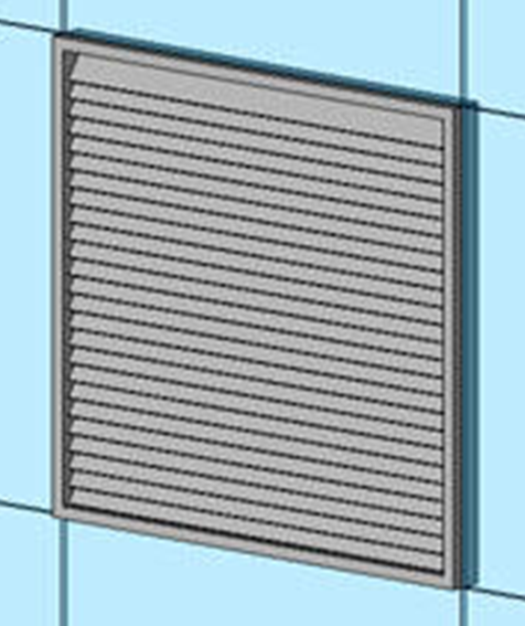

Teafoe, Thx. for the reply.
what i am not sure is, is it going to be curtain wall with panels and louvers. and any videos showing this. need help

Maybe have a look at this curtain panel family.
http://www.revitcity.com/downloads.php?action=view&object_id=6277

Many Thanks it really helped me. i shall post some pic's later. thx. again. W

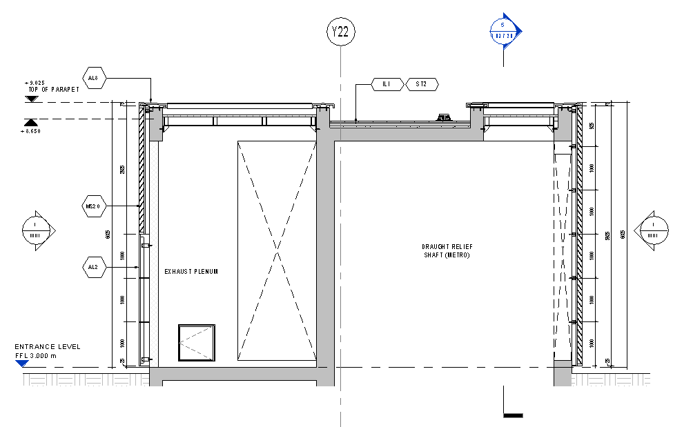

Hi All,
Done it. Have a look.
Thx to All above.
W
