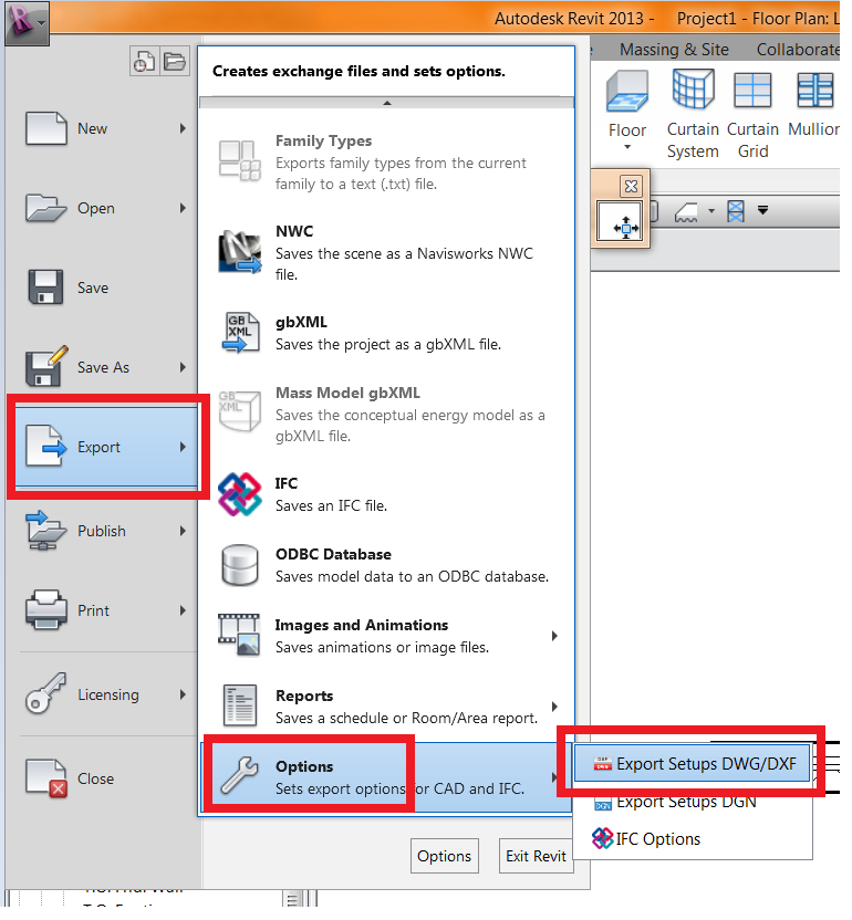

Hi,
I'm struggling on the matter to separate different materials in to their own layer when exporting to dwg.
Walls/Floor (more) - concret, wood, steel.. etc
but so far I cant find the solution. Somebody know if its possible and then how? If not possible, do you have any trick/tips on how I could go around it?
/Kautar

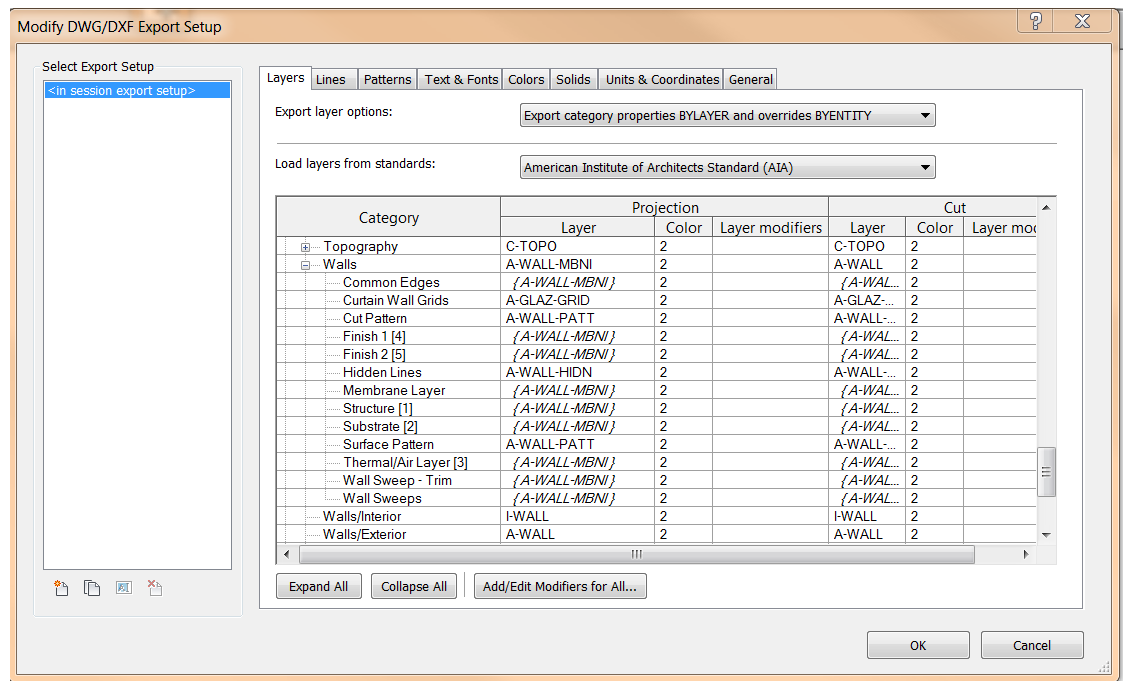

The only thing you can do is assign the REVIT wall structure layers function to an autocad layer. Not quite 'material' related but pretty close.
Click the big purple R > Export > Then schroll to the very bottom 'Options' > Export Setups DWG / DGN > Then open up Walls under Model Categories and map the REVIT Layer function to an AutoCAD layer name. See images.
