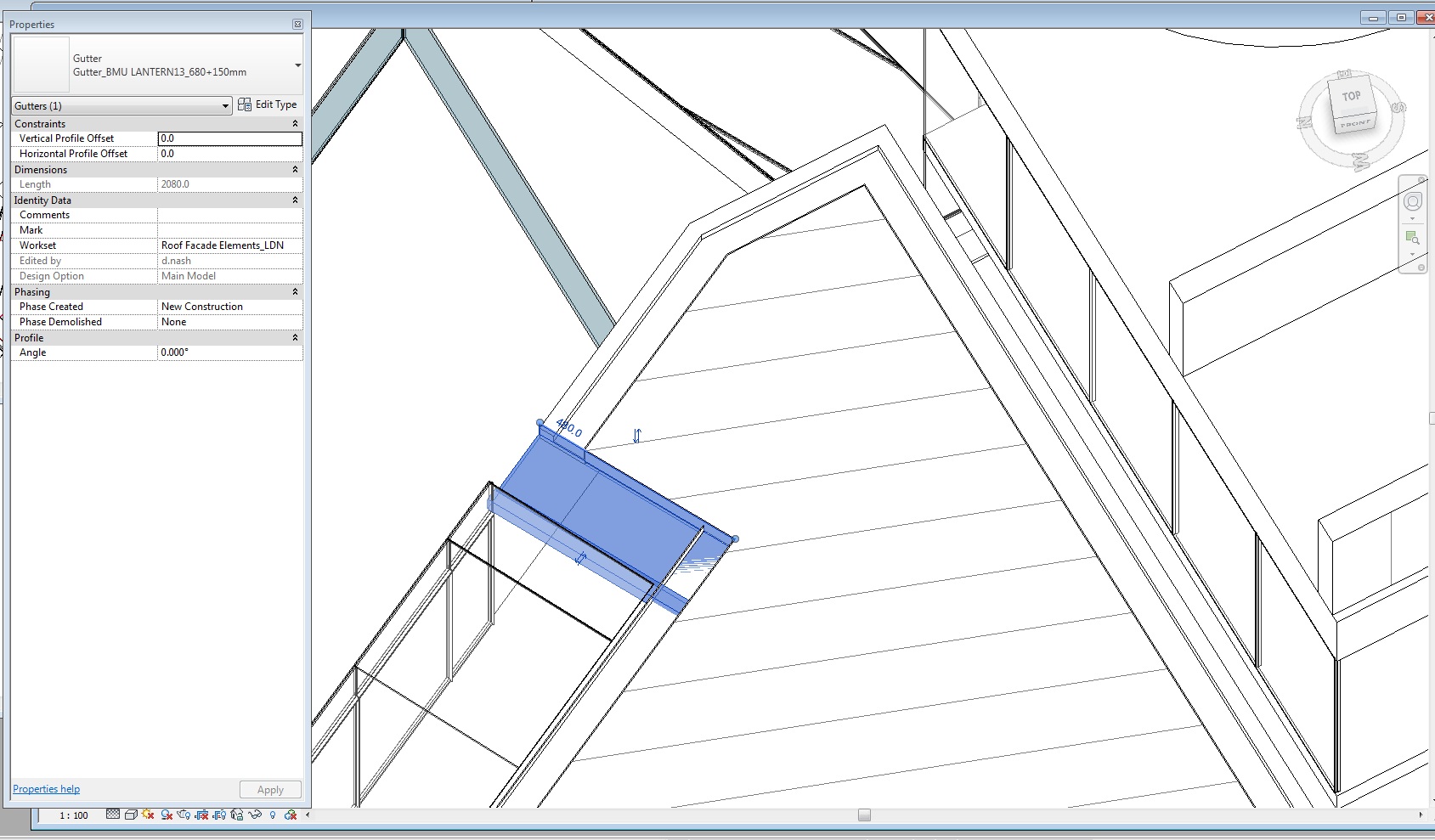

I have two gutters of different widths intersecting at a corner.  Iv attached an image to explain the problem.
Basically, I am wondering how I deal with the corner detail at this interesection...any help would be very much appreciated.

i think the only way  to do this is model in place generic model, solid to close the corner and void to open the intersection
