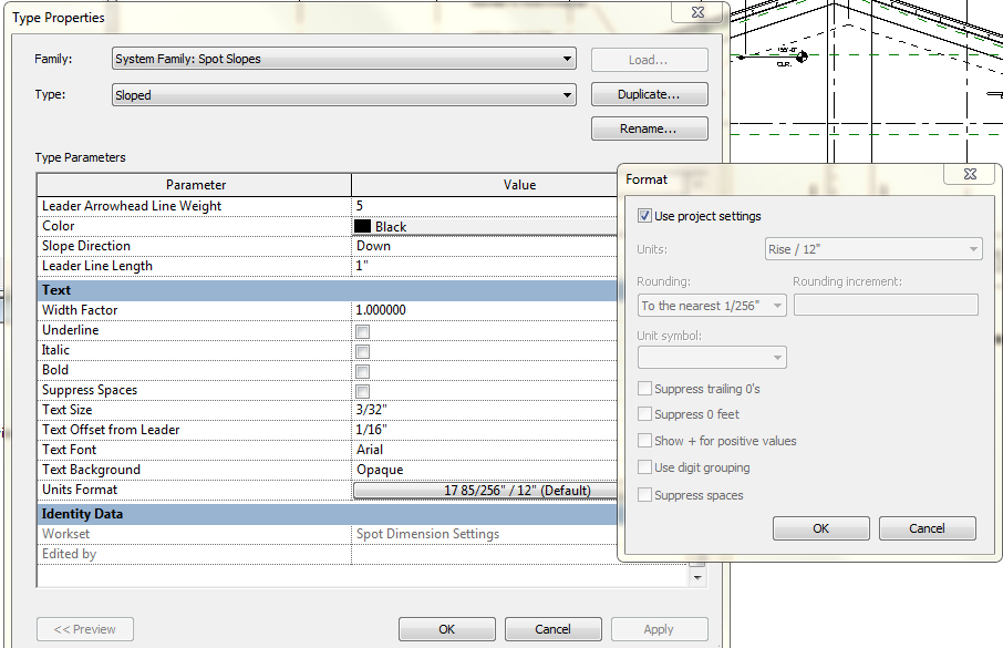

Why I can not get the XX% format in the slope annot in 2013? Only xxx/1000 format appears. Please help.

Under Manage>Settings>Project Units you can change how you want the slope to appear.

Of course I know that, but nothing changes when I change that setting. Why could be that?
Fri, Apr 12, 2013 at 9:33:20 AM | slope annotation problem in revit 2013
Change it in the annotation properties.  It does not have to be project units.

At last ! ! T H A N K   Y O U   V E R Y   M U C H. !! I love you all guys.
