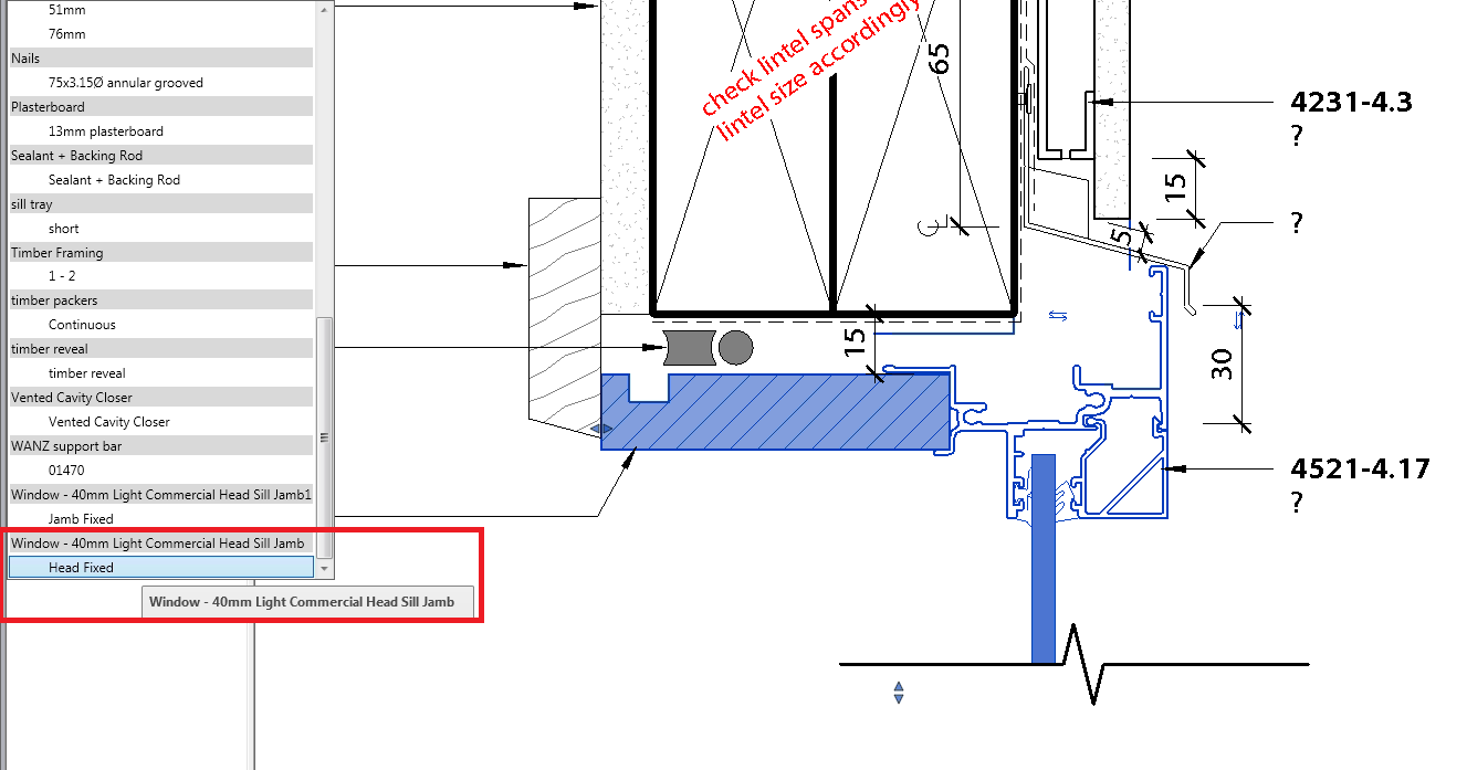

Regarding the insert view from file option; how would I go about importing families within that view so that all of the type properties/options copy over to the new project? I am currently importing the views and only the visible option is imported into the new project.

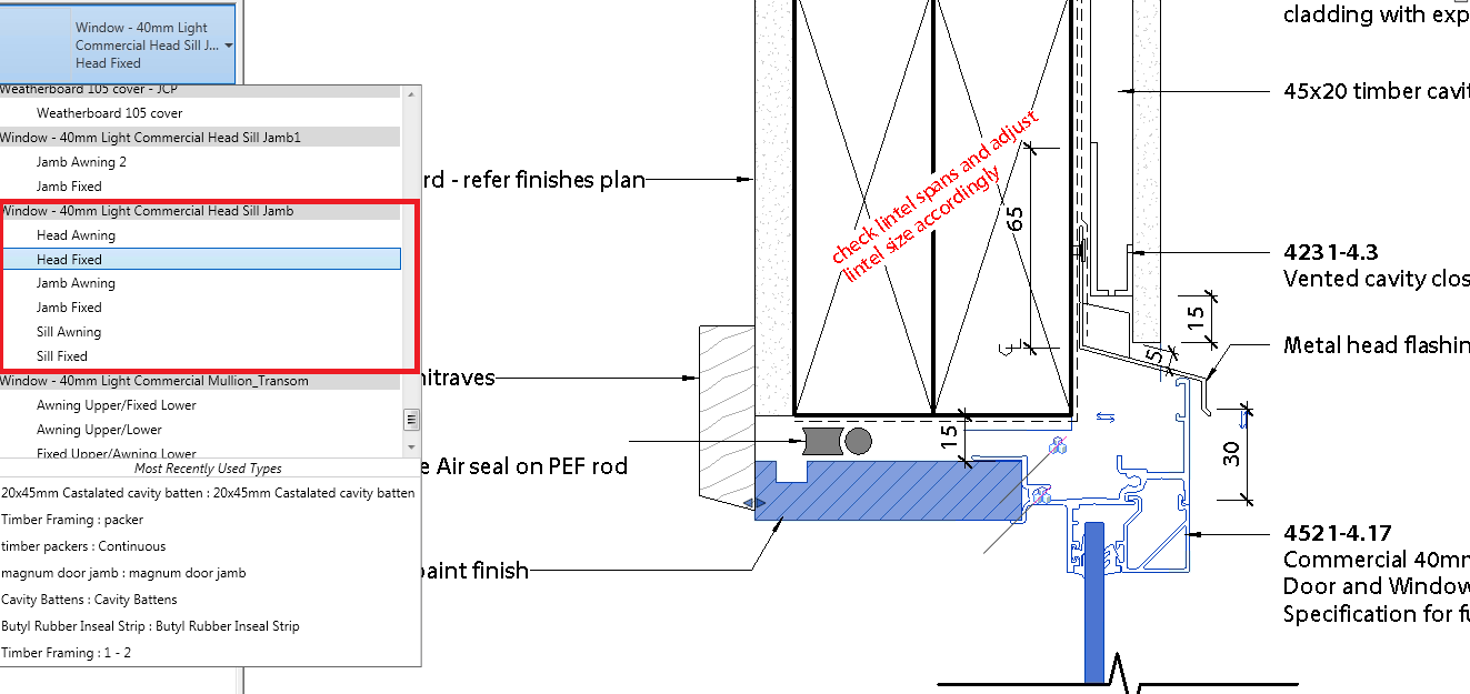

I tried the way you just described and still came up with the same problem of type properties that are visible are only copied into the new project.
Hopefully the attached files show what I'm meaning. 1.png shows the file that the window family was copied from with all of the type options, and 2.png shows what is actually copied across to the new project.

They both appear to be the same family and type and that is what you asked for.
If you want all the types, then click on the family, pick edit the family, then load that into your project.  Now you will see all the types.
