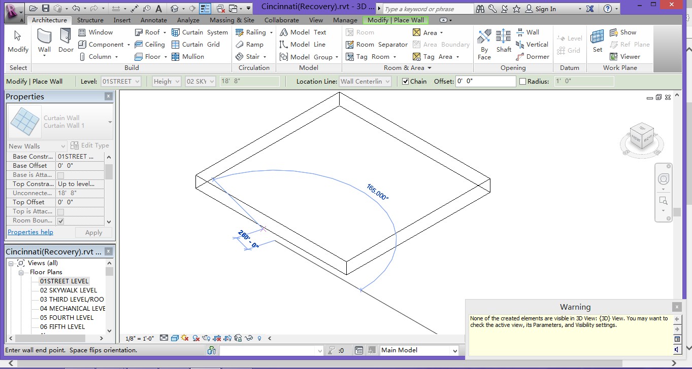

I couldn't see my models in 3D views, I have checked my the visibilites setting,and turned on all the elements,and phising, and work set, section box, everthing I could check. but I still coundn't find my models in 3D views, where esle could I set the visibilites?

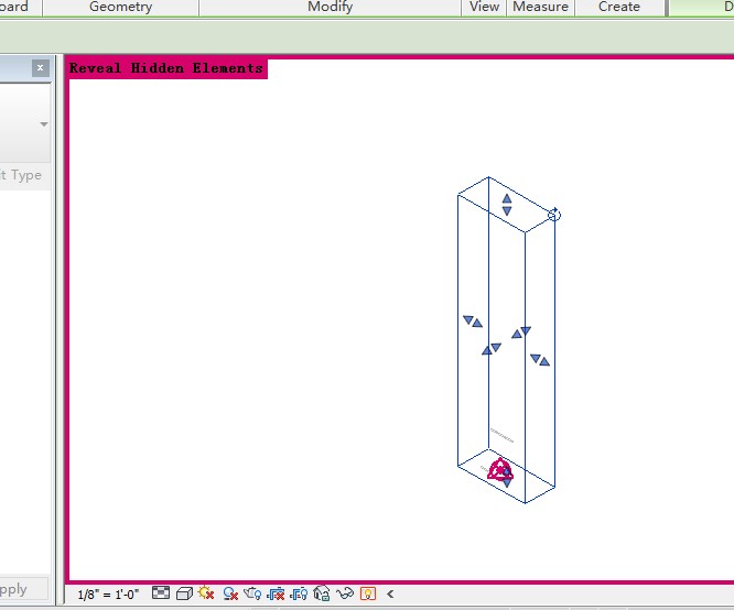

I have solved the problem, it was crop view range. What I neet to do is just extrude the section box to my levels.
