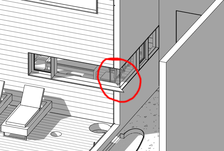

Hi Folks,
I have two different horizontal width mullions joining at a corner, (as you can see it the image sample) but I can get to make it right. Seems that is difficult when the width varies.
I could model an in place model for this corner, but seems there should be another way around to control how different with mullions join at a corner.

Seems to me that is the only solution you have given Revit... a mitered corner and all miters are 1/2 the angle.
Model in place is your answer.

Curtain wall mullions (specifically corners) need a serious overhaul. We need an API.
Wed, Apr 10, 2013 at 1:24:57 PM | Different horizontal width mullions corner
We don't miter these.  We extend the CW to the edge of the other CW mullion and then we add a grid at the glass corner and don't have glass in that last sliver panel.  Square mullion by-pas corner, not mitered.  Renders and shows correctly in all views.
