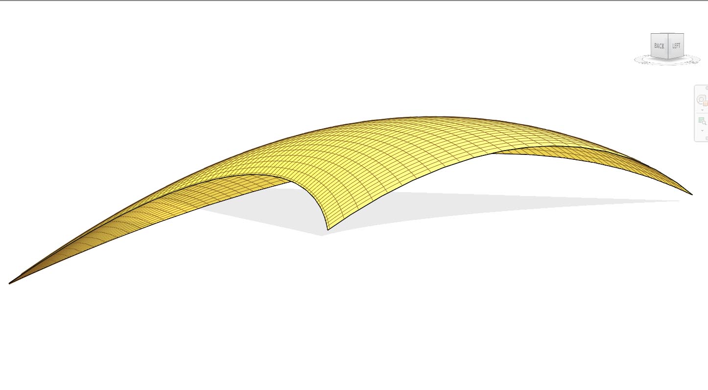

I've created something very simillar to quinns family, but like his, mine also can't make a roof from face when loaded in project.
Revit divides curved sail triangle into 3 small curved triangles and a flat one. My mass can create roof from 2 curved and a flat one, for the last one it gives an error.
And the question is: WHYYYYYYYYYY??
It can easily create wall but impossible to create a roof. There are restrictions when making a roof and I'd like to know them
