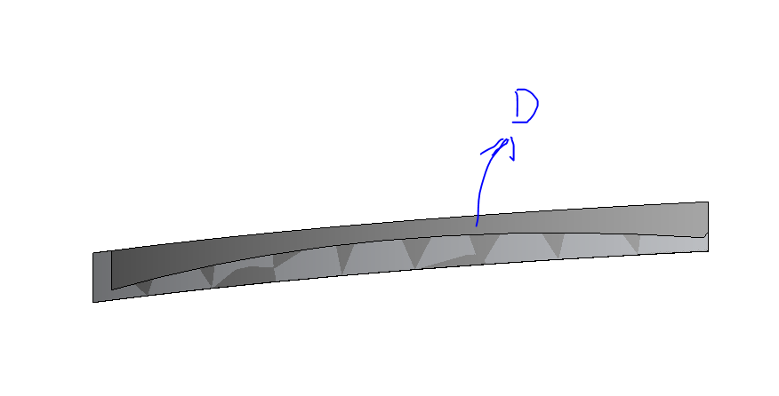

Hello,I am trying to apply Wall by face on curved solid which was cut by voids.But the generated wall is ignoring the voids and it is fallowing the original surface, before beeing cut by voids.Any suggestions?

Im not understanding what is going on, attach an image.  Sounds like you just need to cut the wall with the voids.

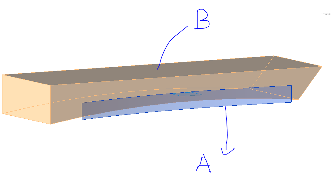

A. original surface which is curved
B. void mass to cut the original surface
When applying the wall on this surface the wall is exactly the same as the original surface without considering the cut done by void....

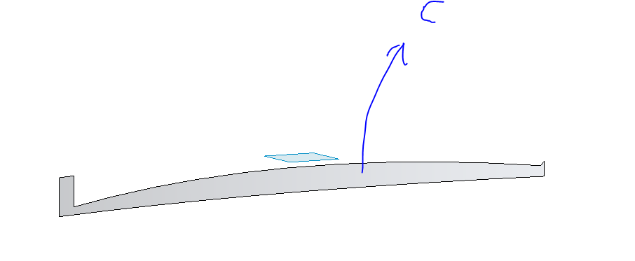

C: the mass surface - I would like the wall to be the same shape
D: the gnerated wall...

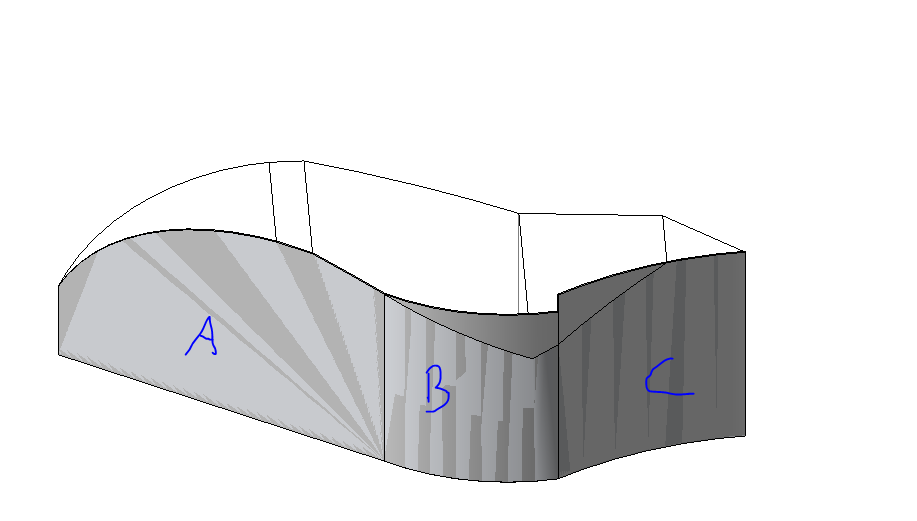

I tried on a different shape, done with solids and voids,
as you can see wall A was correctly generated, wall B and wall C NOT!
Any idea what is the logic behind it?Thanks

The only solution I found was to not use voids in the mass. Find another roundabout way to make the mass with no voids and then the new wall will be the correct shape.
