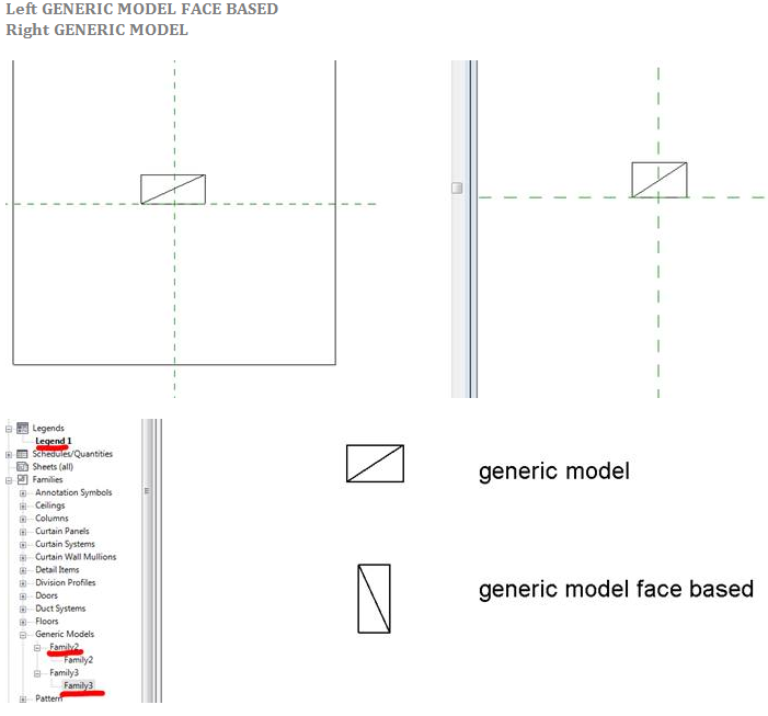

Hi all
just want to ask if  there is any trick to load a face based family to a legend view? As compared to a normal generic model family, the face based has rotated 90deg from its supposed orientation (floor plan view). any tricks/help?
Edited on: Mon, Apr 8, 2013 at 4:04:25 AM
** dont be mad, i dont have much... i am homeless
Mon, Apr 8, 2013 at 7:51:44 AM | FAMILY ORIENTATION IN LEGEND VIEW
I doubt you will find an answer to why this is.  There are some legacy issues in the software.  Some early, inconsistent rules.  One of the ones I don't like is front/back in a family.  That causes problems with how the defaut 3D image of the family shows.  For now, we just live with these problems.

thank you. now i can continue creating family with this in my mind.
