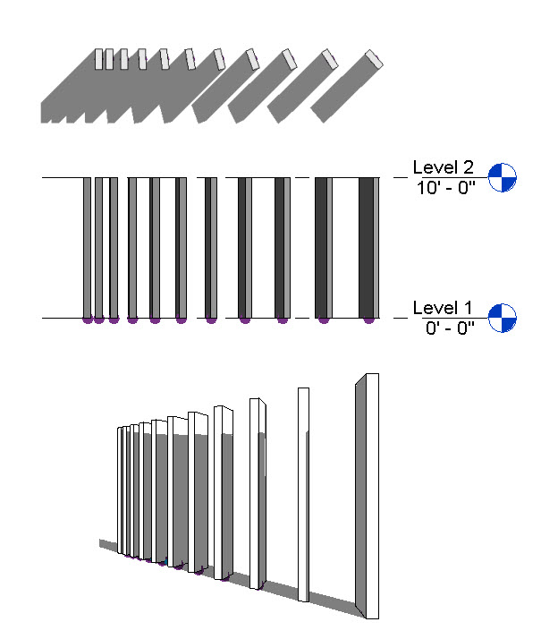

Hello,I would like to achieve this result with elements in a row:A: the spacing is progressively biggerB: the spacing and rotation is progressively bigger
as per imagehttps://docs.google.com/file/d/0B9wW_0_r5bZqdURYWVc3b2JsSFE/edit?usp=sharing
Could anybody tall me if revit is capable of such a thing without switching to Rhino?
Thanks a lot

Yes, Revit can do that with Divide & Repeat. No need to Rhino.

Since the process includes several steps, I respectfully recommend you to visit Zach Kron's blog, Buildz. Search for the topics on Divide & Repeat. He has some videos explaining how to create variations in the repeater.

alfmedina, the image that you attached is exactly what I am trying to do.  I am not finding the Buildz video that shows me how to create a rail that will divide and repeat like you are suggesting.  I will keep searching, but if you get this, could you respond with the direct link?

http://buildz.blogspot.sg/2012/06/repeat-and-divide-prt-iv-reactor.html
