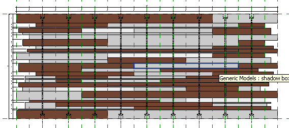

Hi all,I have created a schedule of some parameters of a custom family that I made.  Among those are Length and Width.  Instead of creating a field for Area, which gives me the total surface area of my object, I just want the Width X Length. I attempted to create a Calculated Value, which was Width*Length, but I get this error:  "The following is not a valid schedule field: Width", even though I selected it from the list of available fields by clicking on the box with 3 dots.  Anyone come across this, or know a workaround?  Does it have something to do with it being a shared parameter from the family I created?Thanks,JP

These are Instance parameters from a custom family, that come from shared parameter Width-Shared and Length-Shared.  I also discovered I cannot select Calculate toatsl under Formatting - related?

I actually found the solution.
Looks like having a dash in the parameter name was making Revit think of subtraction.  Fixed it and everything is working well now.  Still can't calculate totals, but I can live with that.

I created a simple family, which is just a rectangular extrusion.  There are several types, each with a different material.  The height property is set by type, the length and width by instance.  I wanted those dimensions to be scheduleable, so when I made a composition like the attached, it would be simple to schedule each piece, listing length and width.  That way I can simplify fabrication.  In order to make the instance parameters report, I had to also define a shared paramter (Width Shared, Length Shared) that equaled the initial Width and Length instance properties.  I also wanted to use the area to do a quick takeoff so I knew how much material to buy, but using an Area field gave me all the surface area, not just L X W.  So I wanted to use the schedule to multiply my Width Shared field by the Length Shared, giving me the area.
