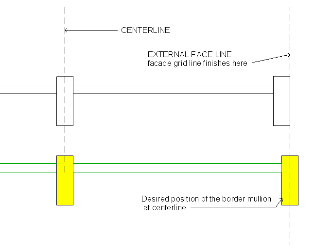

I am trying to design the border mullion of the curtain wall, in a way that its centerline alignes to the border gridline.
For default the border mullion aligns the external face of it to the gridline,but I would like it to act as the internal mulluon - aligning with the centerline.
How can I make it?
Thanks a lot!

All mullions are defined from the curtain wall location line.  Look at the offset in the type property.

I attach the image for better explanation (the plan)
I would like that the border mullion does not stop at the end point of the curtain wall system but that the border mullion has its centerline at the curtain wall end point.

The solution is very easy but I was frustrated almost one day before solved this problem.
Go to Properties -> Edit Type -> Construction -> Profile and change the profile to Default.
Than check if Width on side 1 and 2 are equal and then reload again your final profile.
(Ensure that family profile is properly done . Define Orgin  should be marked in Center (Left/Right) reference).
